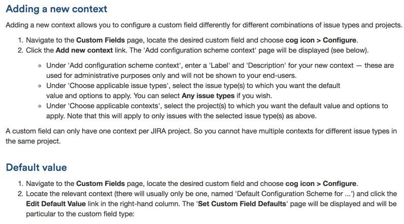

Attempting to follow the instructions below, I came up with the following configuration (seems like duplication to me), and when I select a transition that contains the field, the value Checked is not checked.
Instructions:

Hi @Phil Bustin , why are you using 2 different contexts?
The first one is global (all issue types, all projects)
The second one is restricted to the mentioned projects for all issue types
Default value and options are the same.

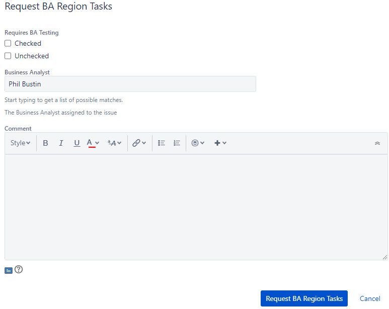

Do you have screenshot of your transition screen?
When you are viewing an issue, is the field displayed on your screen with value Checked?

Do you have screenshot of your transition screen? Below
When you are viewing an issue, is the field displayed on your screen with value Checked? No.
