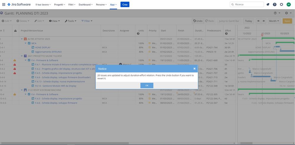

I use the WBS Gantt Chart App to make Gantt charts on my projects. Once I finish the planning, I save it and exit the Gantt. When I enter again in the same Gantt, however, I get the message reported below.
Can you tell me why? What does it mean? What happens to my planning if I press the Undo button (apparently nothing)?
In particular, I would like to know if I am doing something wrong in the way I use the app or in the way I set the settings.

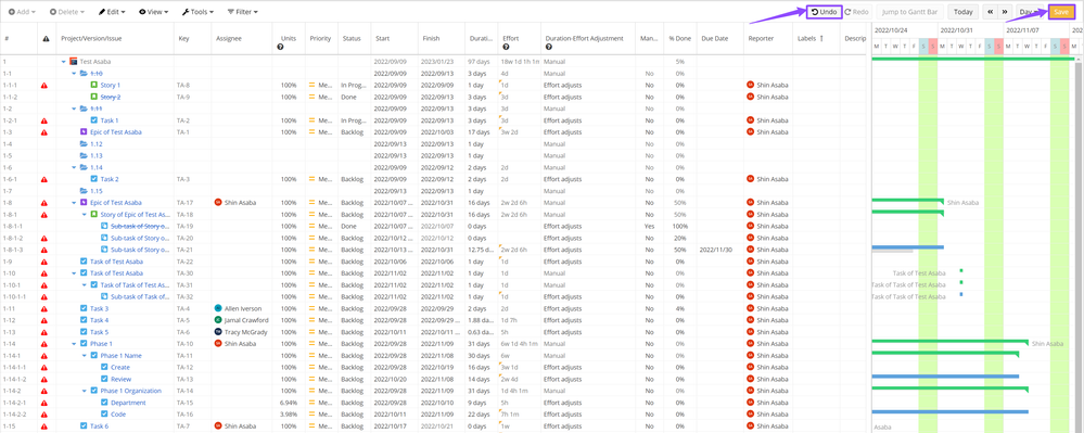

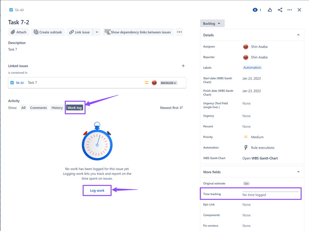

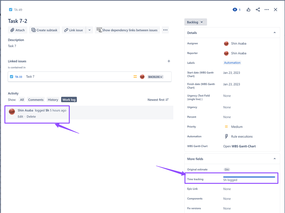

The reason for the “Notice“ dialog box popping up is that you set the “Default Duration-Effort Adjustment mode“ to “Effort adjusts“ and log work to update the value for the “Time tracking“ field in the Jira issue detail screen.
Please see the below images for details.
Default Duration-Effort Adjustment mode: Effort adjusts

However, I still do not understand one thing.
I set "Duration adjusts" (not "Effort adjusts") in the "Default Duration-Effort Adjustment mode" field and I haven't used time tracking yet.
I have only limited myself to changing some precedences between tasks and some start dates. Then, once I saved the file with these changes and closed it, when I reopen the file I get that message.
Did something happen to the schedule I had made before closing the file?
Sorry for so many questions, but I want to understand if I am doing something wrong in the settings or theoretical concepts on which I base my project management.
Since you have the “Duration adjusts“ mode enables, it will automatically calculate the values of the “Effort“ and “Unit“ columns which leads to the “Notice“ dialog box popping up.
If you do NOT want the “Notice“ dialog box to appear and to use the automatic calculations feature for those fields, I would highly recommend that you manually update them by changing the “Default Duration-Effort Adjustment mode“ to “Manual“.
