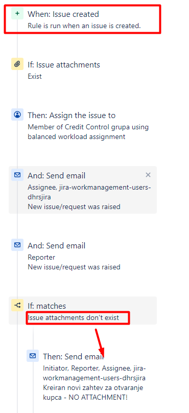

I have a following automation which should trigger an e-mail notification being sent to a reporter if ticket has no attachments, but it doesnt seem to work, as no notification is being sent to a reporter, or others...
The first part works, but the second ("else") doesnt... And it should be working (as if there is no attachment in the issue, it should send an e-mail to the reporter.)

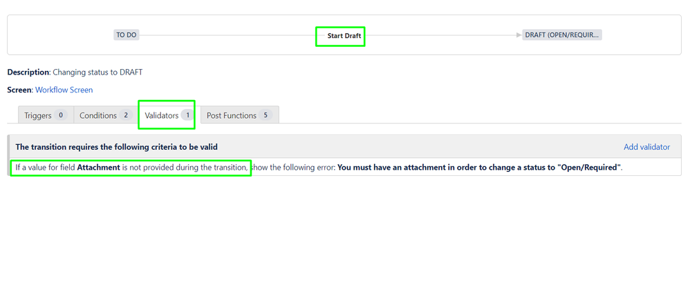

regarding the error associated with the manual transition can you share your validation details. I suspect you are requiring an attachment during transition vs. simply requiring the existence of an attachment.

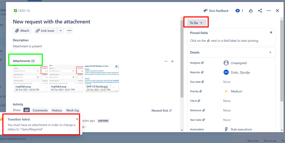

Regarding the validation - please find attached screenshots. Ive also found a workaround for this by adding a transition screen, but then it would require user to RE-add the attachment again, even if he did so in the initial creation step.
This Validator requires that you update the field during the transition which is made clear in the text of your image. Generally you use Conditions to prevent a transition if a preexisting condition is not met. You can setup as follows…

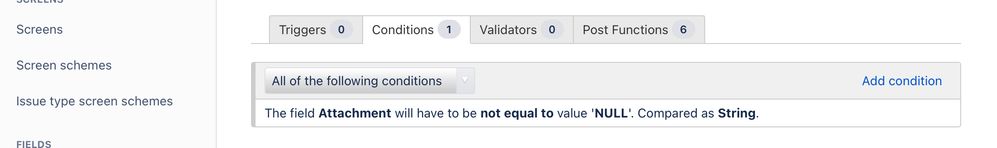

use the “!=“ operator and leave value field blank.
Hi @Jack Brickey ,
the method mentioned works and it solves the "validation" properly :) (like i responded above), however it doesnt indicate to the user why he cant switch a status which would be nice.

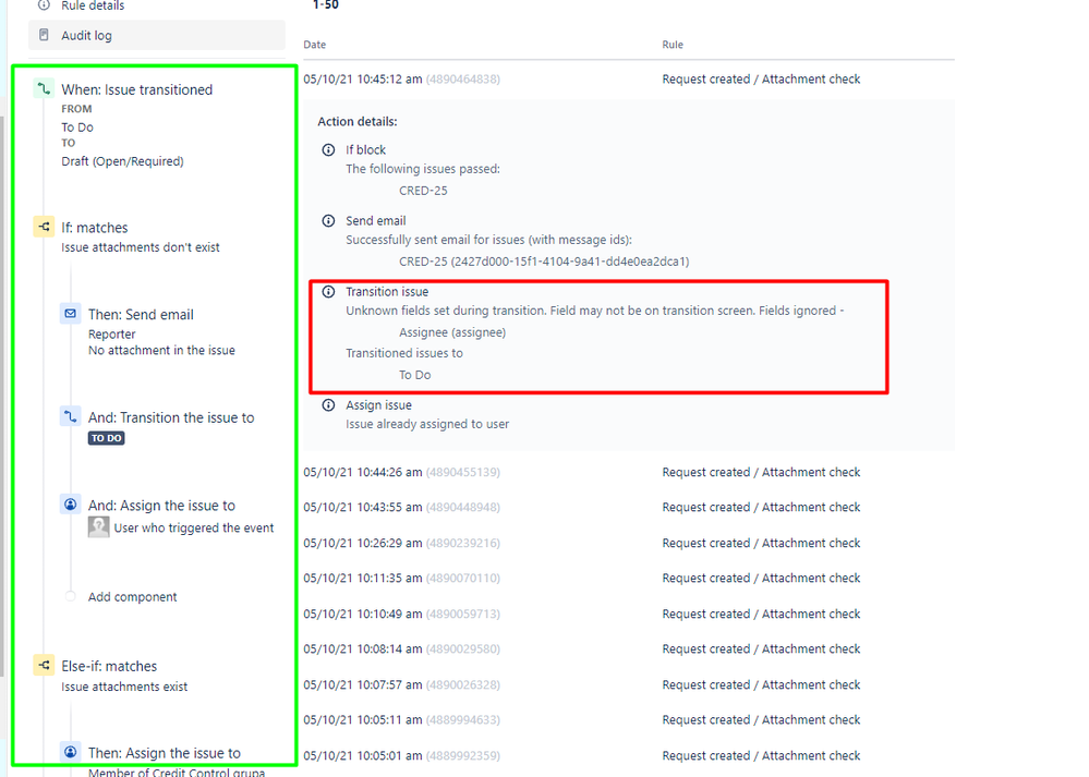

ive rebuild the automation , and mail-sending works, but now ive got the following error message in the log (please see a screenshot).
Ive also tried to add a validation in the transition displaying a message if there is no attachment, but in that case - even if there IS an attachment - message is displayed and system reverts the status to "TO DO", which shouldnt be the case (Second attachment). Ive reported it on https://getsupport.atlassian.com/servicedesk/customer/portal/23/JST-697775

Hi @Dokic_ Djordje - are you getting an error? Is it passing the second condition?
Can you post a screenshot of the audit log for the rule?
You shouldn't have a validator AND try to send an email based on the validator failing. That's going to give you problems.
