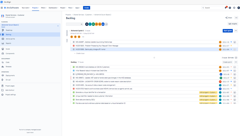

I have a Jira Scrum board, and when I am at it in the backlog view, I want to see my epics, in the backlog pane at the bottom of the screen.  I've checked and my board filter is showing them in the filter view, but they dont show up in the backlog pane.
I dont want to see them in the sprint pane (I know I can filter there on epics), or in the Active sprint view, but in the backlog view, I should see all the items that my filter allows.  If I dont want epics to show I will use the filter to exclude them.  FYI the filter I'm using is:
project = SSCU AND "Team Name[Dropdown]" in (Customer-POBacklog, Customer-Alchemist) AND issuetype in (Epic, Story, Task, Bug, Subtask, Sub-task, "Work Order") ORDER BY Rank ASC

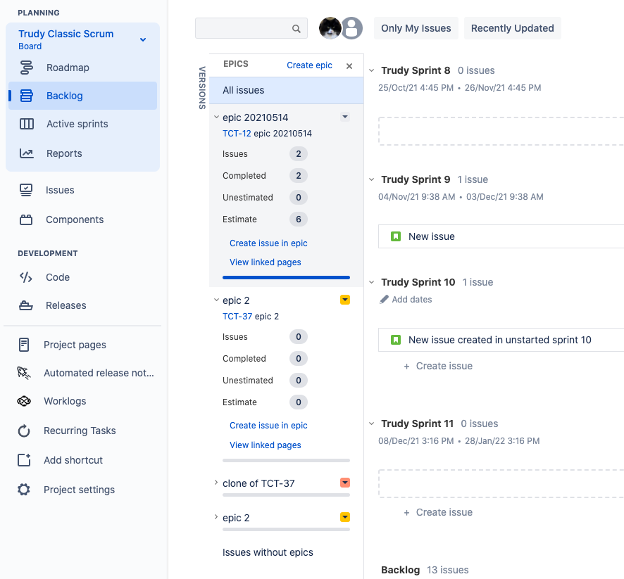

The Epics will not show intermixed with the child issues in the list of issues in the Backlog screen for a Scrum board. You can, however, display the Epics in a pane that will display between the navigation pane on the left and the issue list.
There is no support to change the location of this pane.
Does this not address your need? If not, can you provide more information about what problem you are trying to solve, and maybe screen images of where you are trying to see the Epics?

In the screen shot below, I have several epics that I would expect to show up in the bottom backlog pane.  Filter is good, but apparently Epics are  a special case, and I dont understand why.
