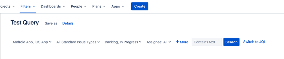

First, create a query for the items you want to present on your board. Choose "Save As" and name your query.

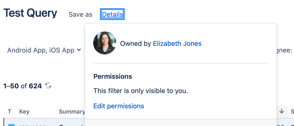

Next, click "Details" and give view permissions to any groups you wish to see this content on the board.

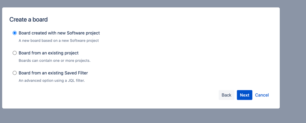

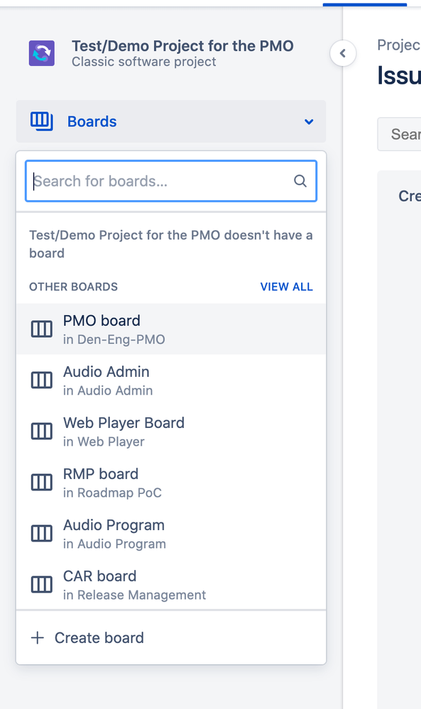

Next, go to the project where you would like to create a new board and select "Create Board" and select your board type. I have chosen Kanban.
Now, select create "board from an existing filter."
Name your Board. Select the filter you created earlier. Choose the project where the board should appear. Then click "create".

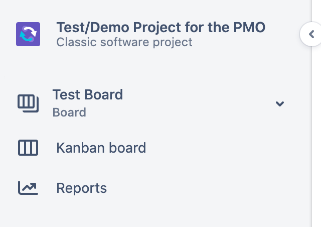

Your new board will now show in the top right corner.
Here's an example:
