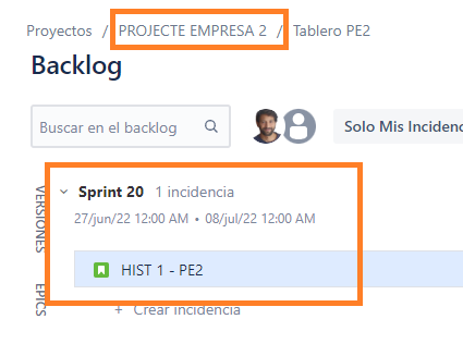

Joan Moreno Maurel June 17, 2022
Hi all!
I have a free jira account, I don't know if I can have one sprint with items from different projects. Maybe I need some screenshots to understand how can I do it.
I've tried to do it this way:
1. I have a sprint number 20 (not started) with items from one project A
2. I've created a new project B
3. I create new items in this new project B
4. I add one of these items in the existing Sprint 20 (from project A)
Result:
I see this sprint in both projects, but I don't find the way to see this sprint with all items from all different projects.
To see the sprint I need to select first one of the projects, so every time I only see the items of that project in that sprint.
Thanks!!
