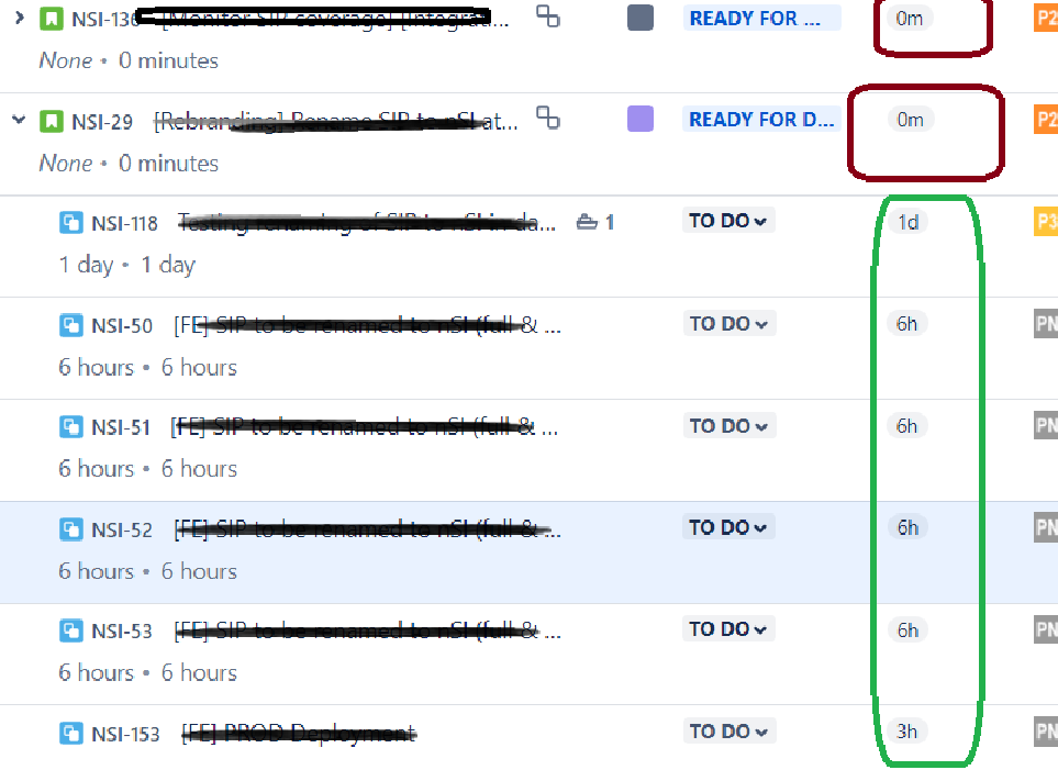

Original estimate of subtask should sumup and show on respective story.
Neeta Dubey
August 26, 2024
The estimates put on subtask under any user story not reflecting on user story. Ideally it should collect all estimates from subtasks and show on user story.

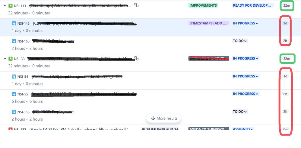

Neeta Dubey
August 27, 2024
Hi @Trudy Claspill ,
Thanks for the info, I created rule and it shows success as well however it is not showing correct data. Please see attached snip.
for NSIp-133 it should be 1d 2h which is now only 32m
similarly for NSI-33 it should 2 d or 1d 8 h.
