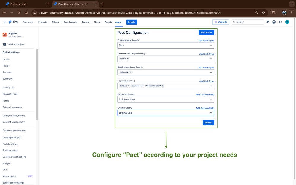

To access Pact, follow these steps:

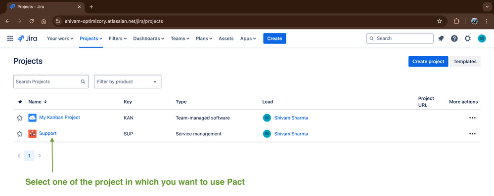

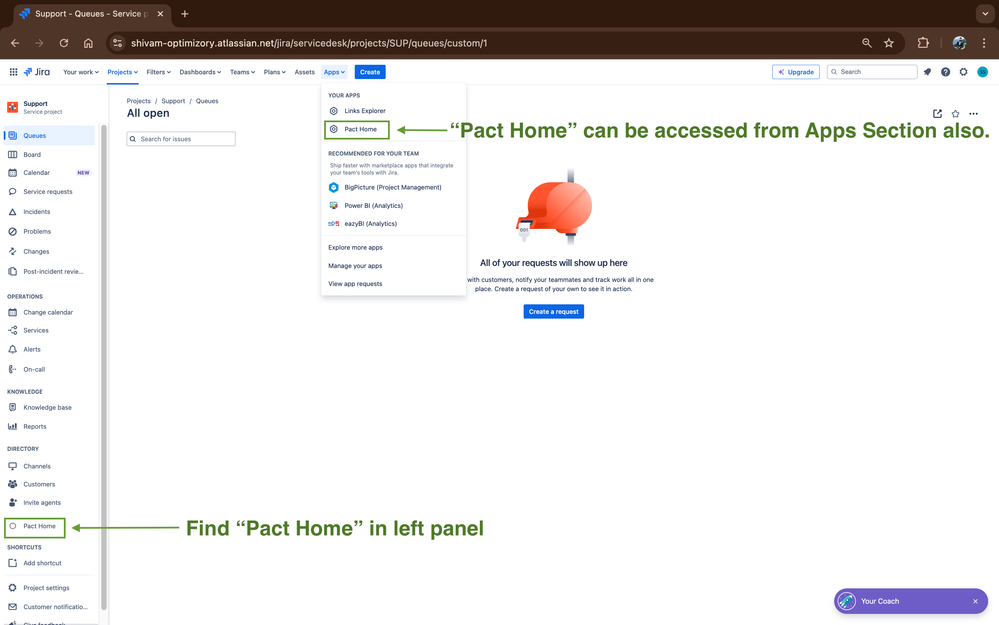

  2. Find the "Pact Home" button: It's located in both the Apps section and the left sidebar of your project page.2nd.png

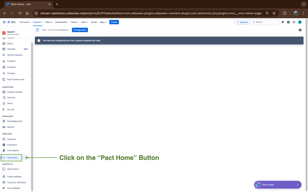

  3. Go to the Pact Home Page: Click on the "Pact Home" button.3rd.png

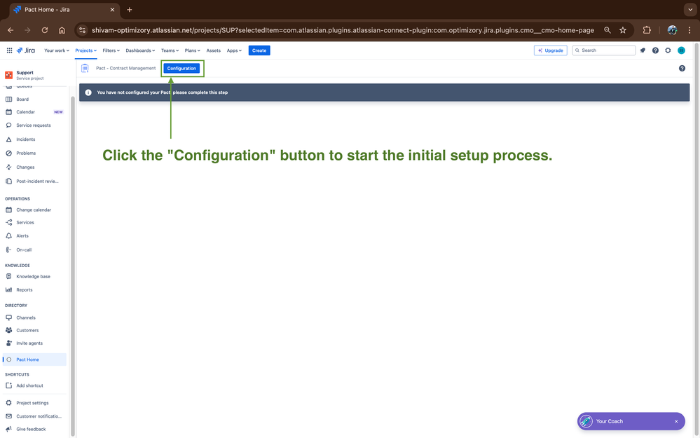

  4. Initial Configuration: On the Pact home page, click the "Configuration" button to start the initial setup process.4th.png
  5. Choose Configuration Type: During the configuration, select the type of issues you want to use as requirements, negotiation, and other custom fields you want to set up according to your project needs.Screenshot 2024-08-06 at 7.03.23 PM.png
  6. Post-Configuration: After completing the initial configuration, you can start creating and managing contracts directly within your projects.

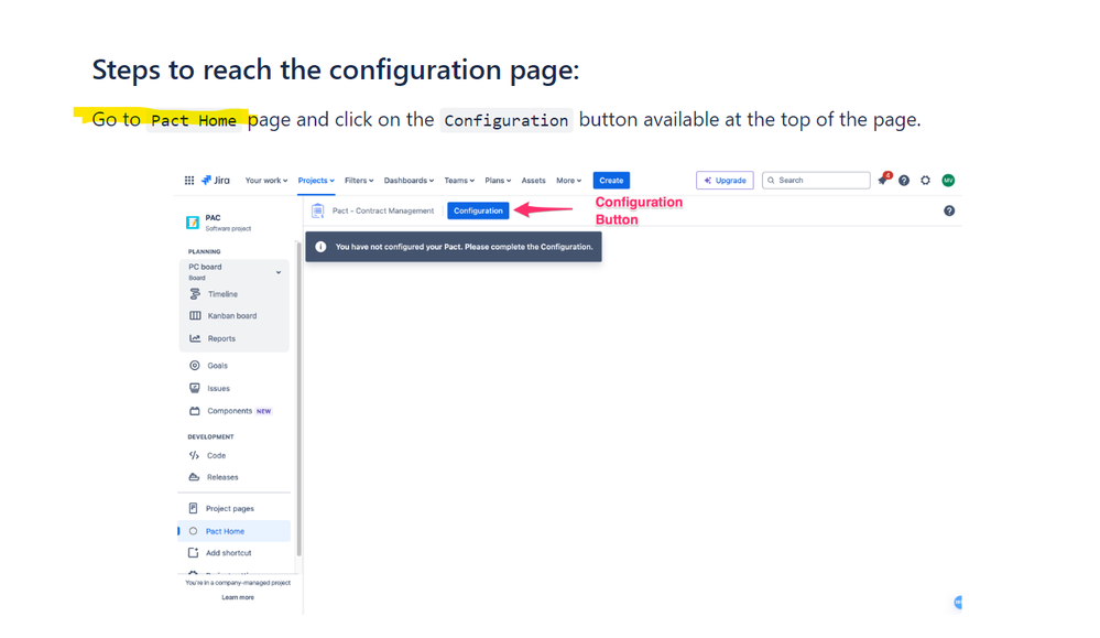

I have reviewed the documentation. It states to go to the Pact - Home Page to begin configuration, however there is no Pact - Home

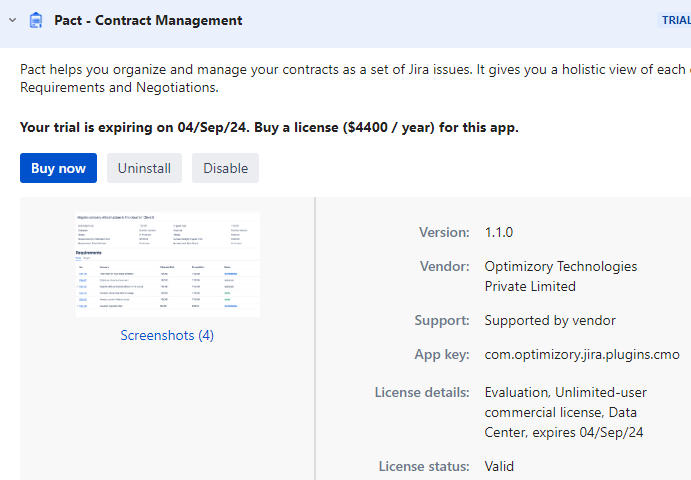

Below is proof it is enabled and active. This is Jira Data Center.
The second screenshot is from their documentation
Screenshot 2024-08-05 161858.pngScreenshot 2024-08-05 161951.pngPage to go to.
