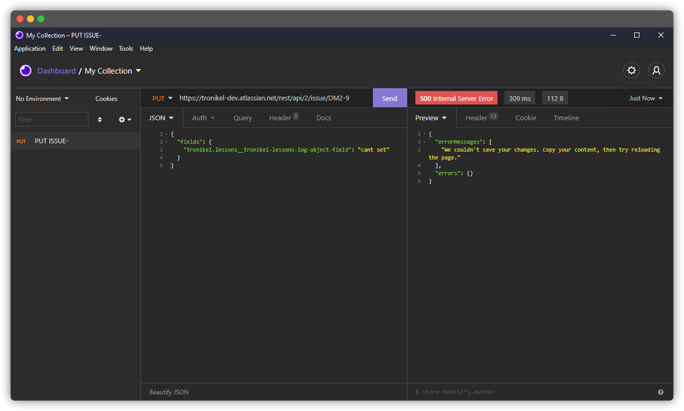

Jira Cloud responds with 500 and
"errorMessages": [
"We couldn't save your changes. Copy your content, then try reloading the page."
"errors": {}
The field that I want to edit is an ace app Issue Field with type “rich_text”

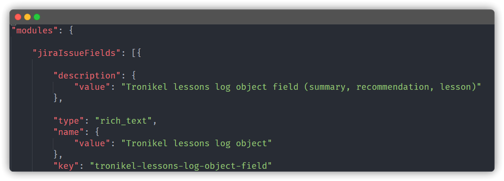

So, I am building an ace app, which has a connect module → Issue Field:

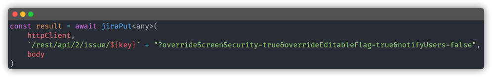

This field gets assigned/updated to a Jira Issue through my app, the request is shown below.

When I call the PUT request for the first time (on an issue which does not have my field assigned) it updates correctly.
But when I change the value and call PUT a second time (the issue already had my field assigned) the error pops up.
And, also, when I call PUT with the same value as the first PUT, it works.
e.g.

BUT, everything works if I change my Issue Field type from “rich_text” to “text”. Sadly, I can’t do that because the 255 character limit is too small for my needs because I’m storing stringified JSON in it.

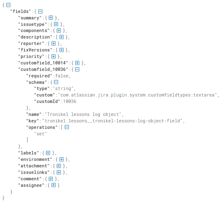

This is what I'm getting when calling /rest/api/2/issue/{issueIdOrKey}/editmeta:
So, does this mean that I should be able to edit the issue field?
The full response is here, if it'll help: https://hastebin.com/agoluqozos.json
Hi @Tronikel
Yes - if a field is in the edit metadata is should be updatable.
