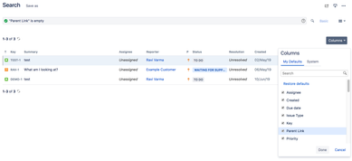

I assume you are using Issue Navigator and using Parent Link in your JQL and you want to see the Parent Link field values for the issues shown in the Issue Navigator.
For that, you have to add Parent Link field using Columns dropdown, which is on the top right corner. Once the column Parent Link is added, the issue results will show the Parent Link field values as another column
Please refer to the below screenshot:

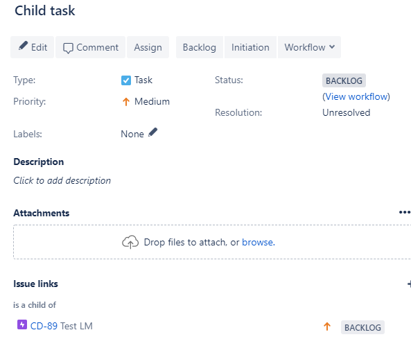

This is the details screen

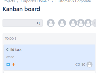

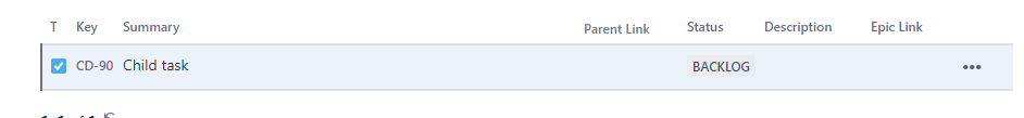

This is the filter with Parent Link column
This is the Agile Card on a Kanban Wall with None

Hi @Louise Mitchell
You should be using linkedIssue in the JQL
Louise Mitchell June 18, 2019
Thanks Ravi - that works :)

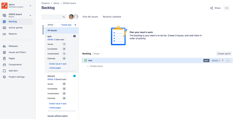

Second Solution
Go to the agile board, backlog screen (click on Epics) as shown in the below screenshot and drag and drop the tickets in backlog to the desired Epic. I would prefer this way, as it is easy and intuitive. You can even create new epics on the fly.
Hope this is what you are looking at.
YAY!
Solution 2 works
All i need to do is move the issues back to the backlog and I can drag and drop them in
Thank you Ravi!
