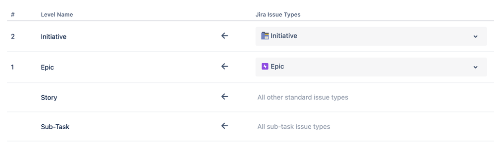

Jira by itself already has a default issue hierarchy that you cannot modify. It consists of Epic > Story > Sub-task. You can add additional issue types at the story and sub-task hierarchy levels, but they must be standard issue types and sub-task issues types at the corresponding levels.
You can extend the hierarchy by creating additional levels. These will always be above the Epic level. You do so via Advanced Roamaps Settings > Advanced Roadmaps hierarchy configuration:
In this example, I added an initiative level above epic. The approach you used to create separate projects for the additional issue types is fine. I did the same. But make sure you also map out the issue types to the corresponding levels here. Repeat the process for additional levels. Based on your scenario I would expect to see:
  • Base mapped to the story level;
  • Epic at level 1, where it is by default;
  • Features at level 2, above epics
  • Course at level 3, above features
You cannot skip levels in the hierarchy. That means you cannot create a parent - child relationship between a feature and a base (task), as that would mean you are skipping the epic level. So that is a first thing that may not match your expectations.
