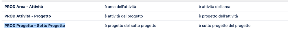

I found this discussion because I'm looking for a solution to a similar problem. I'll explain. I have this structure: issuetype Project that can have one or more issuetype Sub-Project connected with the relationship "is project of" (if I look at the issue Sub-Project) or is "under project of" if I look at the parent issue, say, that Project that has one or more sub-projects linked precisely.

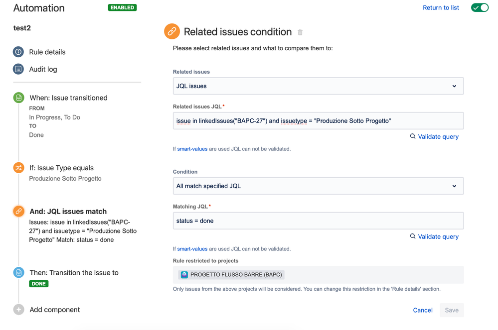

I want to use automation so that every time a status change event is captured to "done" I check if the issue that has changed is a sub-project issue and then I want to go back to its parent issue, the project issue, and then check if all the sub-project issues related to the project issue are in done status.
I hope I was able to explain clearly. I can't build this query with automation for Jira and JQL (p.s. if needed I also have Script Runner, but I can use it less well than automation for Jira).
