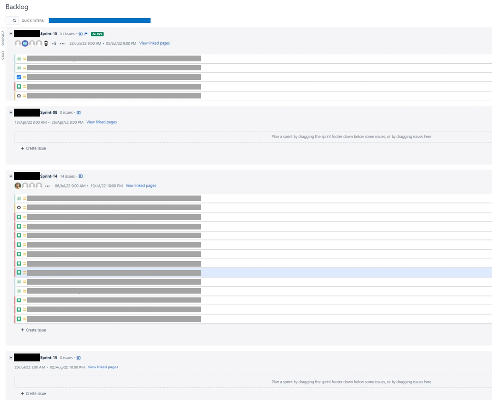

We have a past sprint (sprint 8) that remains on the backlog. I did some digging into the data and found the following:
  • 3 issues didn't have resolution dates so I asked the Scrum Master to add resolution status and a resolved date appeared. Albeit this resolved date is in the future as opposed to when the actual sprint finished.
  • 2 issue had no assignee so this was addressed.
  • 3 issues whilst being assigned to sprint 8 never appeared on the burndown report. All had an issue type Task and looked like placeholder tasks. As they never appeared on the reporting I asked the Scrum Master to remove the sprint from the issues.
I thought this would remove sprint 8 from the backlog as we'd scrubbed the data. However it remains firmly anchored in the backlog (see the image).

My investigation continued and I've found what I believe is the issue.
If you click on the "View in Issues Navigator" in the sprint backlog for sprint 8 the sprint ID is 11111. And this has no issues post scrubbing the data.
However, when you query Sprint 8 directly in the Issues Navigator by typing "sprint = "Sprint 8" you are presented with 2 sprints of the same name.
When the other sprint is selected via a query in the Issue Navigator the sprint ID is 11112 and all the issues are displayed.
My hypothesis is that the Scrum Master created an initial sprint 8 (with ID 11111) and added some issues. Then for some reason created another sprint of the same name which generated a new sprint ID of 11112. Thereafter they used sprint ID 11112, added all the issues and managed the sprint via this ID (11112).
When you review the URL for the burndown chart it ends with ID 11112. And not the rogue sprint (11111). When you change the URL to 11111 nothing is displayed. Or it defaults to the active sprint minus 1 (so the previous / closed sprint) which makes sense I think.
So sprint 8 (11111) anchored in the backlog has zero issues and can be deleted. It will not impact the history. Scrubbing the data as I asked for was correct because 11111 never existed. We were merely correcting the issues assigned to a sprint that never existed.
The Scrum Master has no recollection of doing this, but the data doesn't lie. There are two sprint 8's of the same name and date. And they weren't created magically.
I think that's a fair summary but if you spot any holes let me know.
