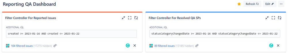

I have a Dashboard where I need to use few Rich Filter Controllers (with JQL filtering only), is it possible to generate permalink with preserved values set up in every Controller?
1. tapping the 'generate permalink button' for the first gadget will generate https://:projectID.atlassian.net/jira/dashboards/:dasboardID#v=1&d=:dasboardID&rf=:controller1ID&jql=created+%3E%3D+-1w
2. tapping the 'generate permalink button' for the first gadget will generate https://:projectID.atlassian.net/jira/dashboards/:dasboardID#v=1&d=:dasboardID&rf=:controller2ID&jql=statusCategoryChangedDate+%3E%3D+-1w
E.R. I need something like 'rf=:controller1ID&jql=created+%3E%3D+-1w' and 'rf=:controller2ID&jql=statusCategoryChangedDate+%3E%3D+-1w' to be in one link

Dam, thanks for the reply!
Yes, I have 'generate permalink' button in every Rich Filter Controller, but the link is preserving state only of this controller, but not other, and I want to have a permalink where states of all controllers will be preserved:
1. tapping the button for the first gadget will generate https://:projectID.atlassian.net/jira/dashboards/:dasboardID#v=1&d=:dasboardID&rf=:controller1ID&jql=created+%3E%3D+-1w
2. tapping the button for the first gadget will generate https://:projectID.atlassian.net/jira/dashboards/:dasboardID#v=1&d=:dasboardID&rf=:controller2ID&jql=statusCategoryChangedDate+%3E%3D+-1w
p.s. sorry if I was not clear, I added a screenshot to the starting message.
hummm such feature seems not available on Rich Filter unfortunately... @Ilya Krasnov you can maybe split your boards and use only 1 controller on each board... thats an idea...
Dam.
