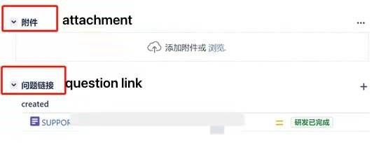

My question is that when the status of JIRA defect is closed, its attachments and problem links, except for the system administrator, do not have permission to modify, add and delete, but visually, how to configure them? Is it configured through workflow properties?

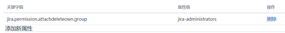

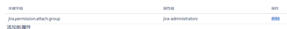

Thank you for your reply. I've seen your answers to similar questions on this site. I try to set it like this:
Set the attribute in the closed state of the workflow: JIRA permission. attach. group--jira-administrators
or
jira. permission. attachdeleteown. group--jira-administrators
jira. permission. attachdeleteall. group--jira-administrators
However, the result is that attachments cannot be deleted in all States of the workflow. They are visible and can be added. And has no effect on the problem link.
I need your professional guidance

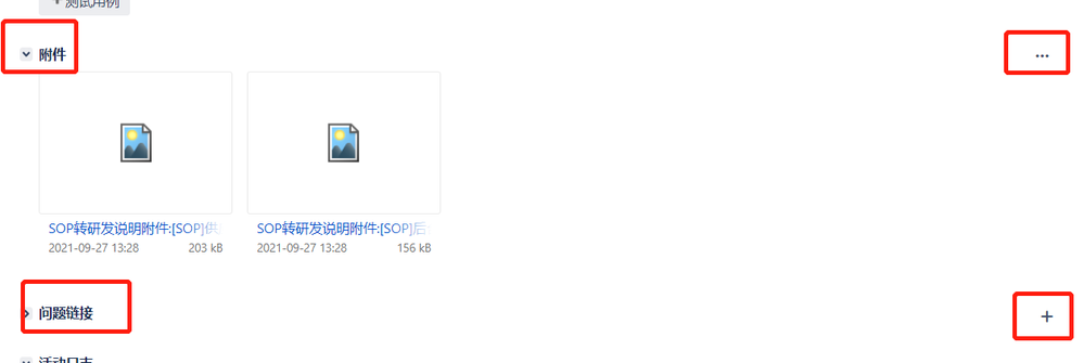

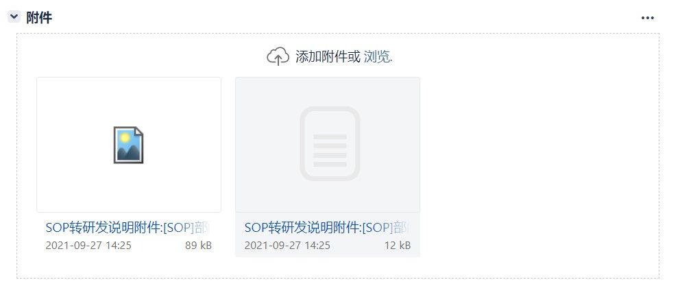

2、Work properties are configured in the work status "R & D completed"
3、Attachment view for JIRA Administrators group

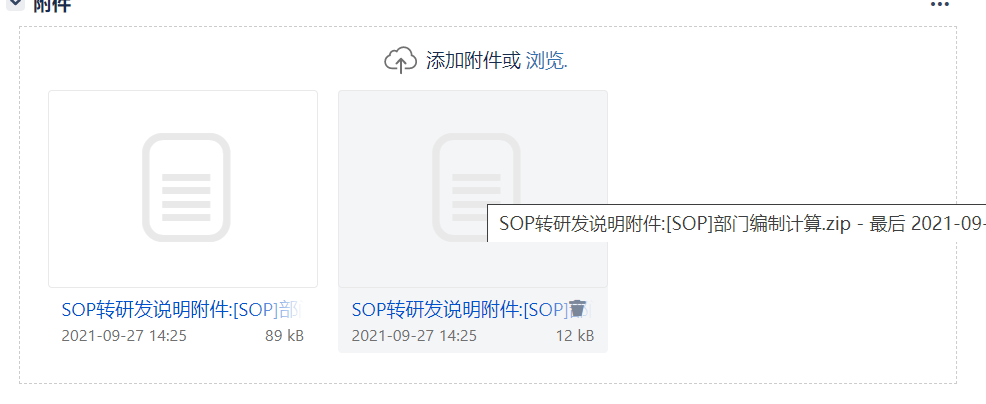

4、Attachment view for non JIRA AdministrFor the same workflow, the properties are set in the "R & D completed" status
The non JIRA Administrators group still has permission to add attachments。

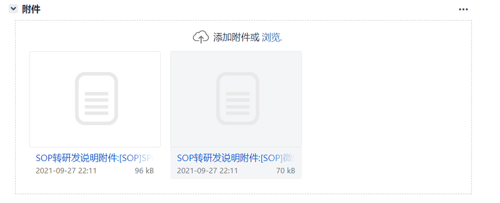

1、For the same workflow, the properties are set in the "R & D completed" status
2、Attachment view for JIRA Administrators group
3、Attachment view for non JIRA AdministrFor the same workflow, the properties are set in the "R & D completed" status
In short, I hope that when the problem is "R & D completed", the attachment and problem link have no permission to modify, add or delete except the administrator group, but they should be visible.

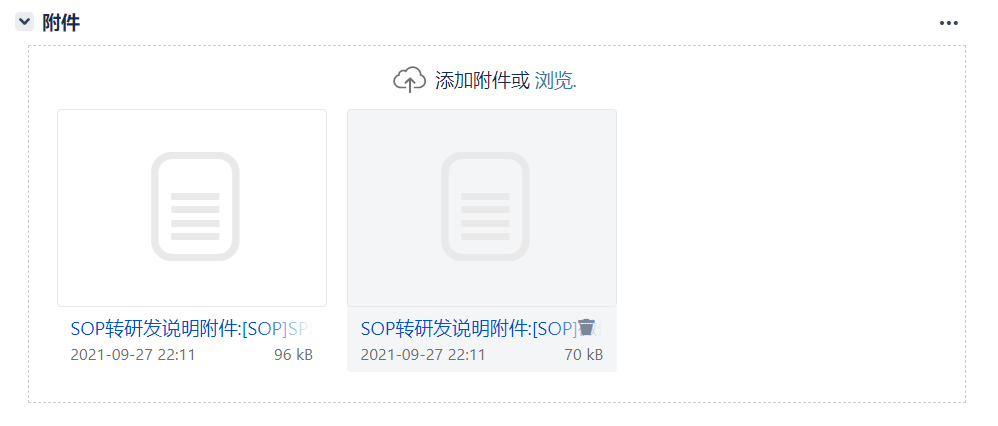

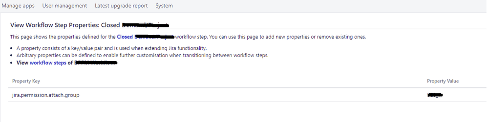

Hi @liusu ,
Please add the following properties as step properties in your status:
It should prevent all users (out of jira-administrators) to attach or delete files just for that status and not for all the others.
If you remove these properties, are users able to attach/delete files?
I just performed a test on my local env and it works like a charm.
Fabio
