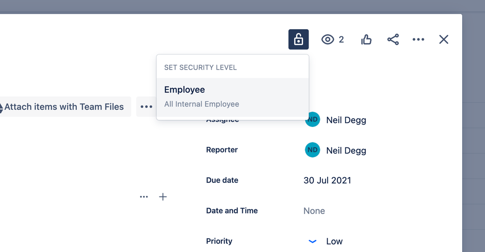

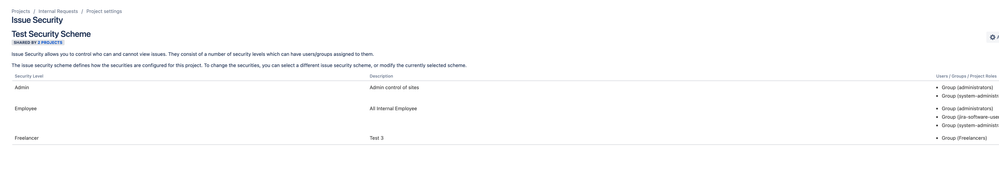

Harrison Plowright June 30, 2021
@KAGITHALA BABU ANVESH I set up security permissions using groups as you suggested. But now as you can see in screenshots, even though I have created three security groups, only one comes up?
Thanks in advance for your help, I'm not sure what's going wrong?
