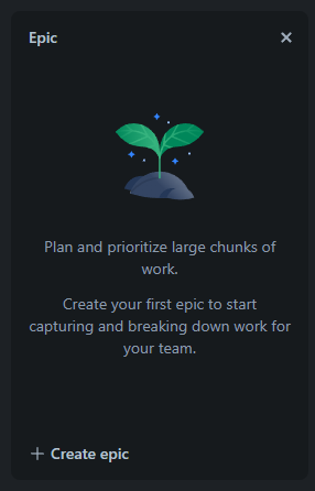

I'm have a Jira project that I've renamed, and changed the code for as well (from EC to CL for this example).
Now whenever I add an Epic, it shows in the Epic panel, but disappears after the first refresh.
Similar thing with Sprints, where even though I have sprints set up, they do not show under the project's sprints when assigning a sprint to an item.

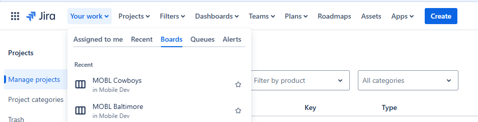

Hi @Anton Vasserman , welcome to the Atlassian Community and thanks for your post.
Please check the filters on the boards you are looking at. They are likely configured for name you replaced.
You can navigate to the list of boards here ^ and then filter by project to check the filters for each board.

On top of that this is an issue with the Backlog and not the Board, I'm missing my Epics in the Epic Panel, not the Board itself.
The backlog representation and board use the same (board) filter. The control switch "use epic panel" switches the epics from appearing in the backlog listed (they go to the epic panel instead).
