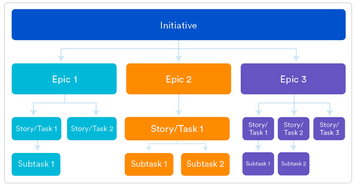

Something that you might be looking for is an "initiative". It's at a higher level than Epic is and can help you organize your epics under one "initiative" or program, if you will.

Jira has a built in 3-level hierarchy for its issues:
Epic
-- Story/Bug/Task
---- Sub-task
The middle level (Story/Bug/Task) are where you have issues of different types (i.e. Story or Bug or Task) that should be units of work that can be completed within a Sprint. It is at that level that you would assign Story Points and/or Effort Estimates and those would be used to establish your teams Velocity. From the perspective of Jira, these mid-level tasks are all functionally equivalent and managed the same way.
Epics are a way to group the mid-level tasks together to describe a larger unity of work that will take longer to complete. Epics are not required to be used, and you can have mid-level tasks that are not associated to an Epic. Jira has some built in functionality that is just for Epic issue types.
Likewise Jira has built in functionality that is just for the third-level issue types - Sub-tasks. Sub-tasks are a way to break down the work required to complete a mid-level issue. Sub-tasks cannot exist independently from a mid-level task, but Sub-tasks can have their own Assignees and effort estimates/actual work that can roll up to their parent mid-level task.
So, depending on the scope of work you are trying to track, I would recommend that rather than trying to use Story and Task as parent/child, you instead use Epics where you thought to use Story, then break your Epic down into Stories, and your Stories into Sub-tasks.

There are tools that you can add to Jira that will extend the issue hierarchy. Look for Portfolio or Roadmap tools.
Something else you might consider it if you can use another feature to categorize your work at the level where you are currently using Epics. Maybe you could use the Components field to identify those categories, or possibly another custom field for those categories.
