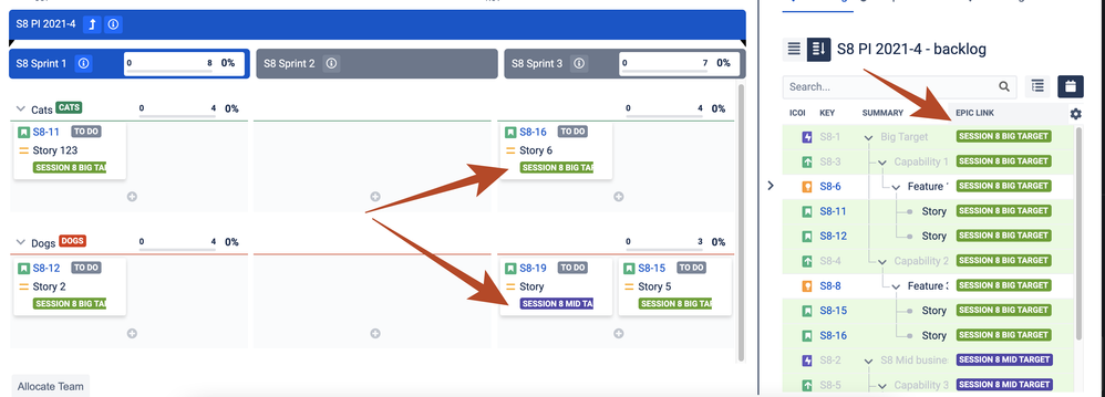

Anna-BigPicture
October 11, 2021
Hi @David Scheer
Indeed, Big Picture and BigPicture Enterprise can support part of the following planning process.
You can rename Teams to Initiatives and set its mapping to, e.g., a custom field of a single select type. See my image below.
For the measurement of resources usage, you can use simple Capacity Planning.
Please let me know if you have more detailed questions.
David Scheer November 1, 2021
Hi Anna,
thank you for your reply!
If I understand your screenshot correctly, you have the teams cats and dogs working on multiple backlog items for the Big Target and Mid Target initiatives / epics.
I would like to switch this around, i.e. epics in the swim lanes, teams as tags.
A similar functionality is listed in your backlog, so I don't think you support that, yet: https://jira.softwareplant.com/browse/ONE-2214
