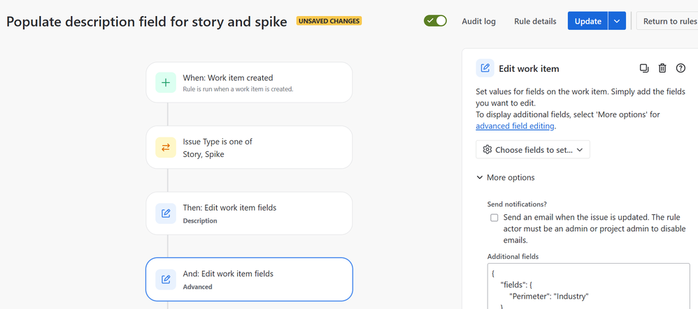

I created a custom name "Perimeter" which contains 2 values : Industry ; Headquarters.
I would like to populate it when I create an issue. So I use an automation like this :
But this doesn't populate my custom field (previous action which sets description field works)
How can I do ?

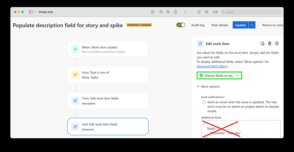

Try deleting all data from the "Additional fields" area and use the "Choose fields to set..." button.
add the editing of the field in the first action "Edit work items fields" -> Click on it, then click on the dropdown in the middle are of the action (right side of the screen) and choose the "Perimeter" field. It will then pop up a little bit further down in the action, and you can select the value.

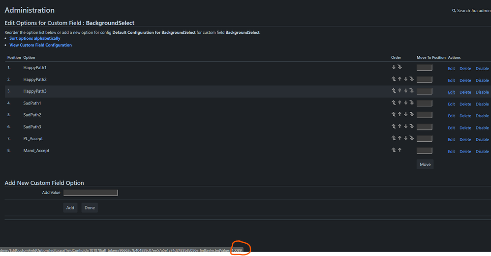

Navigate to your customfields in jira, go to the "Perimeter" field, click on "context and default value" and then "edit options" for the context youre interested in. Once you hover over the "edit" link next to the option youre interested in, you can see the id in the url (see bottom end of the following screenshot).
"fields": {
"customfield_10103": 10879 (or whatever your number will be)
