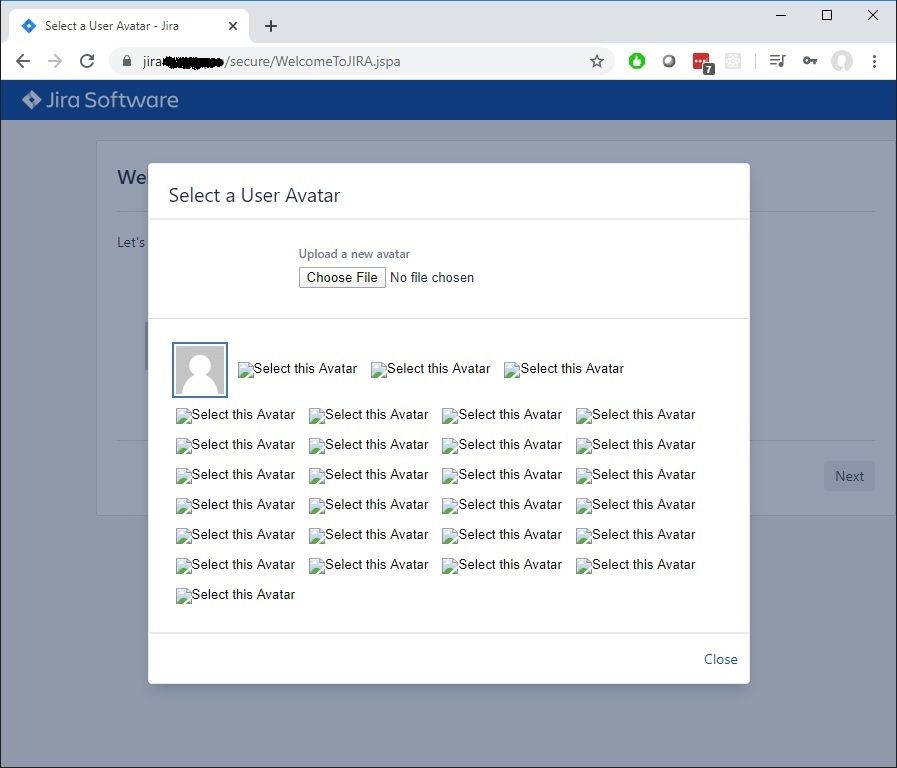

×This is related to https://community.atlassian.com/t5/Jira-questions/Some-of-jira-links-point-to-localhost/qaq-p/1317799#M412573
I have uninstalled jira and installed it again fresh. Changed all "localhost" config references but it seems that they are hardcoded.
Can I get a version that is known to work ok?

First time I have tested it without proxy; the same problem.
Replaced all localhost with domain.tld
I did exactly as recommended in Configure Jira server to run behind a NGINX reverse proxy

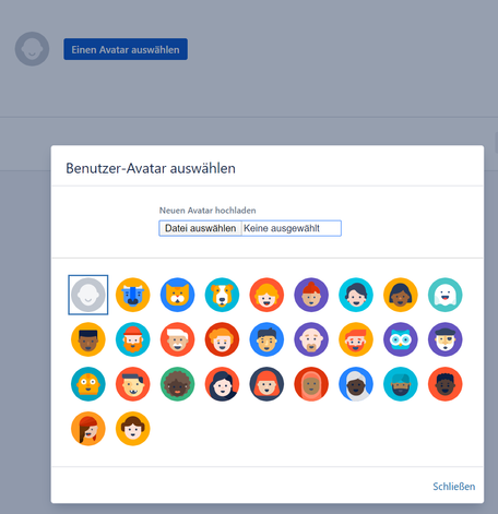

I just checked on our 8.7.1 Jira with a newly created user. We use an Apache HTTPD reverse proxy in front of Jira handling SSL and other stuff.
Avatars on the mentioned page (WelcomeToJIRA.jspa) are displayed correctly:
So I assume, it might be a configuration / caching issue on your side.

Almost the same situation here - except that I am using nginx instead of apache.
Is there a known incompatibility between jira and nginx?
The thing is that most of jira works ok; only some of the links point to localhost.
I mean, I could add/edit projects/issues etc.

I have uninstalled nginx and I tried to use apache; unfortunately there is another problem with apache - I get a mix of http and https links.
Can you help me with a config for apache/jira?
I followed the guidelines Securing your Atlassian applications with Apache using SSL and I get exactly the same problem as I got with nginx.
