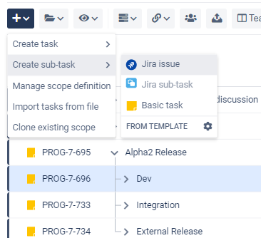

Hi Supporter,
I want to add in some existing JIRA tickets per single key ID or per JIRA filters.
Q1: when click 'Add task' button, seems I can't find one proper option to manually add in an existing JIRA ticket or JIRA filter. Any alternative?

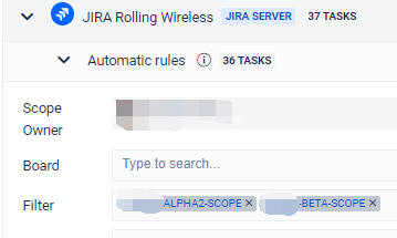

Q2: Instead of manual approach, I tried to add JIRA filter from Scope Definition ->Automatic rules, while the constraints are:
- Although we have different ticket filter within one JIRA project, when auto added one or more JIRA filter, all the tickets are mixed listed per JIRA project, can be resolved?
- I can't specify the filter to be added under which basic task.

1. I've created several jira filters to contain development ticket contents for different milestones.
2. In big picture program, I added few basic tasks for milestone tracking. One is called 'Alpha2 release'.
3. Now I want to manually import existing jira tickets (as sorted in 'Alpha2 release filter' in step1) as its Dev subtasks. But the only way I see is to add the filter into scope definition->automatic rules.
- No button to import existing jira tickets, but only to create new tickets.
- automatic rules would have some constraints as I described in initial question.
