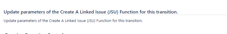

Hmm....I don't have a three dots button anywhere.

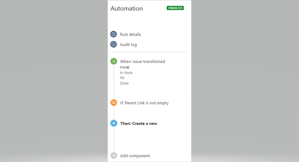

Ahh, thank you for clarifying; this totally worked! I ended up storing the Parent Link as a custom field value (rather than using the Label field), so when I set up the Automation rule, the condition checks if the custom field is not empty.
For others reading through, the rule was set up in this manner:
And then when the issue was created, I copied and set various fields. One field I had to set was a Multi-Level Cascading Select value, which I struggled with a bit, but ultimately got it set by using this format in the Additional Fields section:
"fields": {
"customfield_11111" : [{ "id": "11111"}] }
Thanks so much, again!
