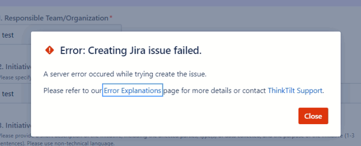

Hi Community,
I'm still a noob in Jira, but learning slowly. I created this form to create tickets but i keep getting this error upon submitting it. Any ideas where to look?

I was able to resolve this issue, it was related to a field linked to another project that was required that i had linked to this form. After some digging, this is now working as intended.

Hey @Christian Delgado
Did you create the form from a template? I believe they are aware of some issues with the templates at this time.
Christian Delgado
March 27, 2022
No, this is a blank form that I created.

Hi @Christian Delgado
What did the error explanations page state?
Does it allow you to contact ThinkTilt Support? Just a question, as Forms are now an Atlassian product.
One thing worth checking is whether...
  • There is a field on the form which is optional and...
  • Field is empty when this error is received and...
  • Linked Jira field is mandatory (when not using a form)
Or...
  • There is a mandatory field on the Jira issue create screen and...
  • There is no corresponding form field linked to it
^ This can create an error, because the form is just an extension of the create screen - and still bound by any mandatory/required fields.

I checked the following:
    • There is only 1 mandatory field in the create screen, but that field is not part of the fields in the form, i also tried adding it to see if it will make a difference but i still get the same error.
    • 80% of the form fields are required and optional fields are not empty upon submitting the form.
    • There is a mandatory field in the create screen, but it is not part of the form, like i said before i tried it with and without the mandatory field but no luck.
Or...
    • Refer to the explanation above.
    • I don't understand this one, do you mean to check if every section of the form is linked to a field? If that is the case, then yes I linked everything to a field and created new ones when I had to.
The last bullet point is effectively what you have stated here...
^ If there's a mandatory field on the normal create screen, it needs to be on the form, and populated during creation.
Assuming you have all the appropriate Project Permissions to create an Issue, and you've tried all these permutations, if it's still not working - I'd contact support for more direct assistance :)
Yes I read that the mandatory field has to be on the form as well through a linked field, this was set up that way initially but it does not work. I will submit a ticket with their support team. Thank you much.
