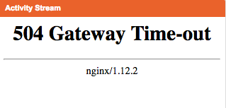

we have a Problem with the dashboard.
The Activity Stream applet takes ages to load and shows an 504 Gateway Time-out afterwards.
I have searched the logs after an error wich could explain the problem but found nothing.

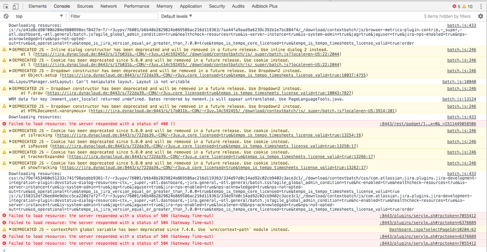

With the developer tools I couls se that there are indeed:
Failed to load resource: the server responded with a status of 504 (Gateway Time-out)
Sadly I have no clue how to fix that Problem.
