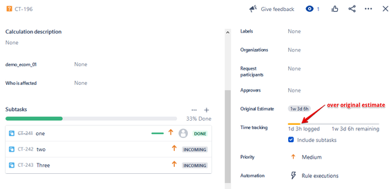

Now, the problem: He opens a sub-task and...
  • If he start logging time to specific sub-task he currently working on, then all that time becomes 'orange' (over estimate) and still it adds to the total time of parent's card.

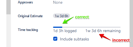

  • If he sets 'original estimate' in each sub task and then start logging, then that extra time adds to Parent's task original estimate.

This can be frustrating and I have dealt with this in the past.  Jira will take the estimate on parent as well as the estimates on the sub-tasks and sum them together on the parent if the checkbox include subtasks is checked.  If you uncheck this you will not have the same issue but you will also not have visibility at the parent of the total time since the sub tasks will not be included.  In the past we have set an estimate at the parent level and have not placed estimates on the subtasks.  In the past we added a custom field to the parent task to get an overall estimate.  Then we used estimates on the sub-tasks and tracked time on those as well.  We did not track any time on the parent.  This allowed us to see the actual work compared to real project estimates at the parent level and compare to the original estimate.  We now use tempo.
