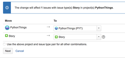

Here is a screenshot from a Server instance, however, the same holds true for the Cloud instance as well:
I took a look at the Inspector in Firefox and Safari and the checkbox area next to "Use the above project and issue type pair for all other combinations" is a <div> whereas the Next and Cancel buttons are in a <p> tag.
If this is a Server instance I would put JIRA in Safe Mode and see if you can reproduce the issue.  If you can then we know add-ons are not causing this and we'd want to look at the browser and the proxy next.
Next I would try an Incognito/Private browsing and see if that helps.  Next I would bypass the proxy and see if you run into the same issue.  Let me know what you find and we'll go from there.
