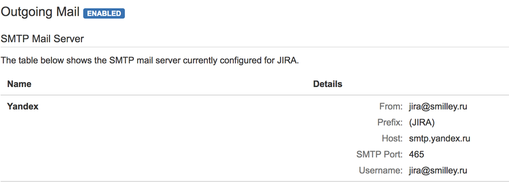

Hi all! I have a problem with outgoing email. I've configured SMTP server and it's working fine when I send test emails. When I want to invite new users i receive the following error in logs:
2017-08-27 19:18:00,426 ERROR [] Sending mailitem To='smilley@yandex.ru' Subject='You have been invited to use JIRA' From='6479463@gmail.com' FromName='jira@smilley.ru' Cc='null' Bcc='null' ReplyTo='6479463@gmail.com' InReplyTo='null' MimeType='text/html' Encoding='UTF-8' Multipart='javax.mail.internet.MimeMultipart@61de541' MessageId='null' ExcludeSubjectPrefix=false' anonymous Mail Queue Service Error occurred in sending e-mail: To='smilley@yandex.ru' Subject='You have been invited to use JIRA' From='6479463@gmail.com' FromName='jira@smilley.ru' Cc='null' Bcc='null' ReplyTo='6479463@gmail.com' InReplyTo='null' MimeType='text/html' Encoding='UTF-8' Multipart='javax.mail.internet.MimeMultipart@34f45a05' MessageId='null' ExcludeSubjectPrefix=false'
com.atlassian.mail.MailException: com.sun.mail.smtp.SMTPSendFailedException: 553 5.7.1 Sender address rejected: not owned by auth user.
So it's "Sender address rejected: not owned by auth user." error. What should I do to resolve it? Thanks.
The account 6479463@gmail.com is not the one you have set up in the email connection. You'll need to correct the outgoing email addressing.
6479463@gmail.com is an email of the admin who is trying to invite users. Is it possible to send an email from user jira@mydomain.com?
It's set to be jira@smilley.ru, but in logs it's set to be an email of currently logged user...

Hi!
I have same problem!
But it was solved by setting same data at "From address" and "Username" fields.
