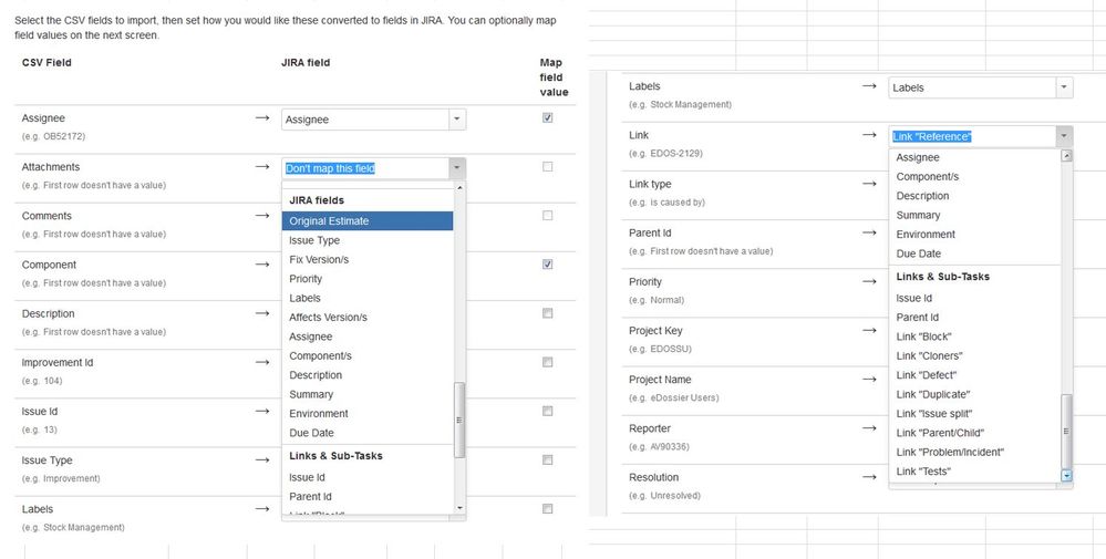

I am trying to import several issues to Jira, usign the csv import.
I use JIRA v7.5.1.
I have followed the article https://confluence.atlassian.com/adminjiracloud/importing-data-from-csv-776636762.html but it seems the functionality on my Jira version is not exactly the same.
For example:
- In the process of preparing the import, in the map fields step, I couldn't find the following Jira fields to map: Status, Resolution, Link type, Reporter, Attachments,
- In the Link field, it already proposes the type of link, and not all the link types are availalbe, as they are when creating a link normally in an issue.
Does anybody know why is this happening and how to map those fields?
Thank you

I did followed the guide you mentioned. The links I want to create, are links to existing issues. The problem is that in the guide you referred, it's described that there is the option to indicate the type of link: "one column must be mapped as Issue ID and the other as the desired link type (e.g. "Link 'relates to'")" but in the practice, as you can see in the screenshot I attached before, the Link type is not an option in the dropdown list of available fields, just Link types (only one field for the issue to link and type of link, and with a reduced number of options, not all the available when creating a link in Jira). The screenshot I attached was from the CSV importer, but yesterday I tried another import from an account of a Jira admin, and using the External System Import, and the available fields to map, related to links were exactly the same...
Do you know if by any chance any plugin must be installed to have this functioanlity as described in the guide you mentioned? I use JIRA v7.5.1, and I understand by the disclaimer in the beginning of "How to Import Issue Links from a CSV File" the functionality should be included...

I "got" access to the external system importer (I found the colleague with Sys Admin rights, and I guided him though the screens), but as said, everything looked the same, except that I got some more fields availale for mapping, but the link options to import were the ones in the screenshot above, and without the field Link type, to map... I'll keep checking and let you know if I find anything different

Bad news, I scheduled a session with the Jira admin, to proceed with the Administration > System > Import & Export > External System Import. There is no option to map the Link type, and Link field can only be mapped to the ones displayed in the screenshot I previously uploaded. On the other side, the field Status and other fields I didn't have available before were there to be mapped.
Why this Link type field is not available?
If I cannot import the link field properly, it's going to cost a lot of work to have it properly, manually
