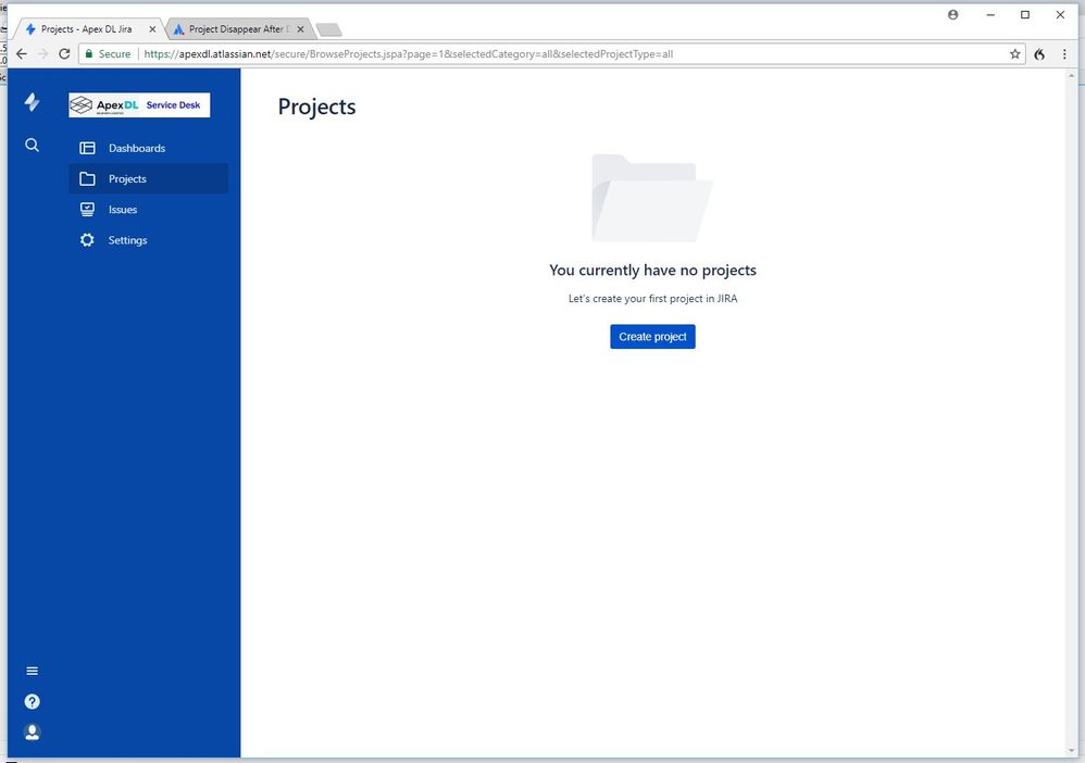

The project is no longer accessible. So when I login using the second account that I created, I get a message that says "
You currently have no projects" when I go to projects.

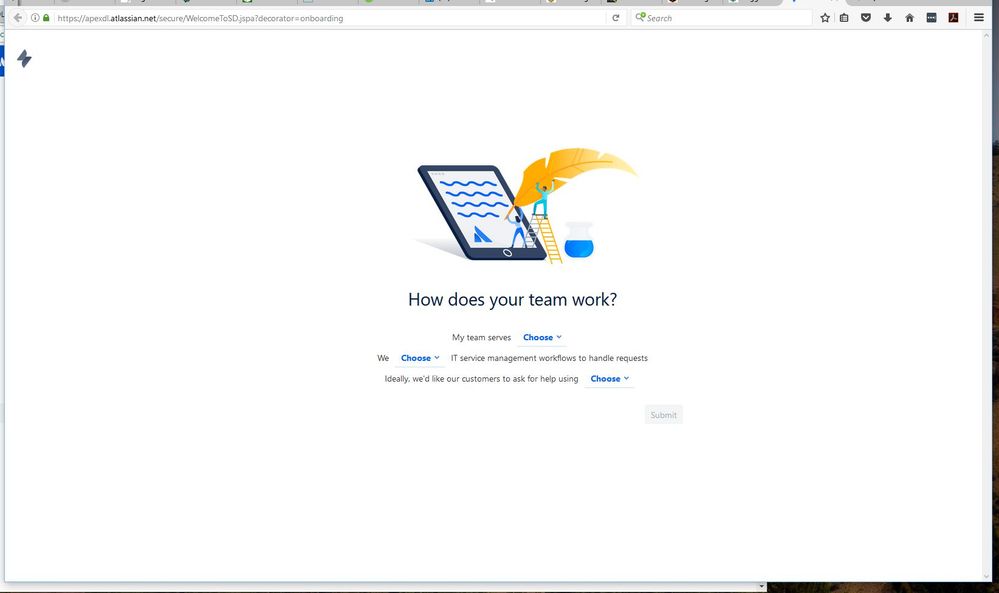

If I login with the original account I get the onboarding page which has the question, " How does your team work?"
See attached screen shots.
First image shows what I see when I login using the original account. I have not tried going through the wizard again because I concerned it might overwrite the original setup I did.
The second shows what I see when I login using the second account I created

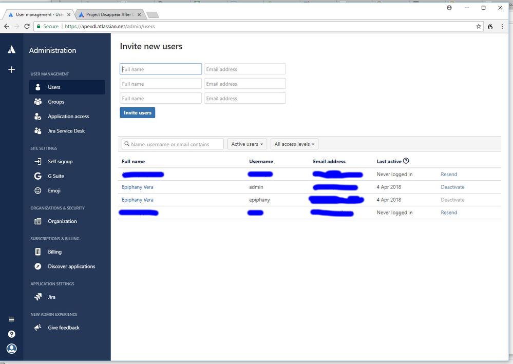

This is the user screen that I can get to after I login using the second account. The original account has the username admin and the second account has username epiphany. They both have admin privileges.

We can see there is only one project. I have given you the necessary permission, can you check if you able to access the project now?
Epiphany Vera April 5, 2018
Yes, I am able to access it now. Thank you so much for your help.
