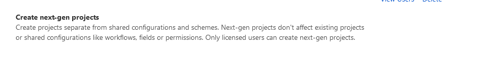

You can remove "Create next-gen projects" permission from users through the Global Permissions Management - Manage global permissions :
Create projects separate from shared configurations and schemes. Next-gen projects don't affect existing projects or shared configurations like workflows, fields or permissions. Only licensed users can create next-gen projects.
Removing this permission does not delete existing next-gen projects.
Users with the Administer Jira permission can always create next-gen projects, even if that group is removed from this permission.

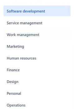

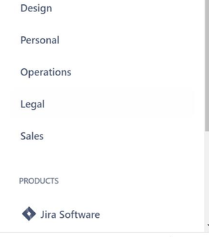

Here is a screenshot of what a user can see. The user is not an admin of the platform but he is a project lead and when he wants to create a project, these are the options for him.
I'm not completely sure why we cannot create next gen or software projects anymore, instead we have these options above (I guess this is Jira Core).

Yes, when there are only administrators available, and you have no further accounts, then they will be allowed to create projects (Users with the Administer Jira permission can always create next-gen projects, even if that group is removed from this permission.).
When you click on Jira Software, for example, there will follow another screen ("page"), there you will have the possibility to choose between a new company managed project or a new team management projects - assuming the permissions are set to do so.

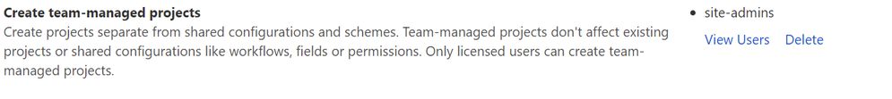

As I mentioned briefly above, the issue I am trying to fix is regarding a user that is not an admin nor in any admin-related groups in Jira but can still create projects. I have checked global permissions and I can see the following permissions that are project-creation related do not include the user:
These are only for admins and the user is not included. I wanted to investigate further and I checked individual permissions, where it clearly states that he does not have the ability to administer projects (which from what I read includes creating projects as well)

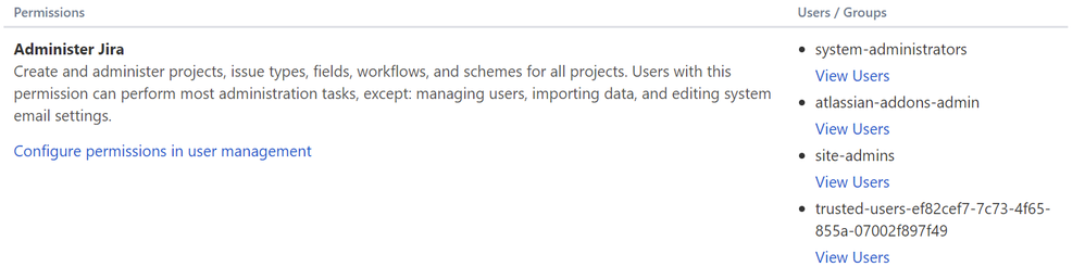

The only thing I can think of that would allow him to create a project is that he is one of these groups that for some reason I cannot edit the permissions for:
When I click on either of those hyperlinks, it takes me to the groups I have created. I can only see the system admin group, I assume the others are default Jira ones that have all users.
Is it correct to assume that because of Administer Jira permissions that includes creating projects, the user can still create projects? If yes, do you know how can I disable this?

Yes, the "Administer Jira" is responsible for granting all listed users/groups the permission to create company-managed projects.
I understood you in a way you have users which still can create projects but are not listed in the permissions for "Administer Jira" and/or "Create next-gen projects". Is this correct?
Could you please confirm the user you want to have not creating new projects is not in any of the groups listed in "Users/Groups" from "Administer Jira" permission and also not in any group listed for "Create next-gen projects"?
Have you effectively tried with a logged in user of them to create a project? In last instance this should not work then - if it should please also raise a request with Atlassian support to let them double check what you have spotted (they likely something strange is going on with your configuration).
There are 4 groups under Administer Jira:
- system administrators
- atlassian addons admin
- site admins
- trusted users
Out of all these groups, I can control who is in the site admin group and trusted users. I do not know how to get to the atlassian addons admin and system administrators groups. Do you know how to access these last 2 groups?

The group for addons should never be touched, it is just a technical group - to my knowledge there is no interaction possible with it.
The "Trusted User" Role grants the user access to Jira Admin features.
So to summarize: if the user which could still create a company-managed project is not with in at least one of the above mentioned groups - they should not anymore be able to create new projects.
