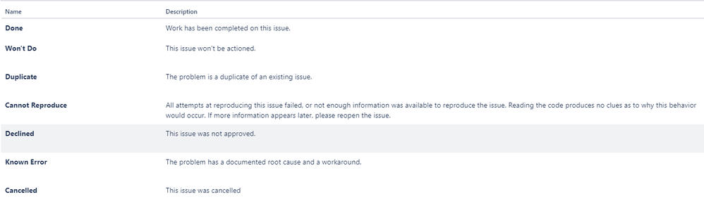

Now I noticed that we might also have user created "None" and "Null" Should I get rid of those too?resolution options.png

Absolutley, yes, you need to get rid of all the false resolutions here!
I would delete all but one of your broken resolutions right now.  This will also simplify the task of removals -  having to look for several different broken resolutions is harder than looking for one!
