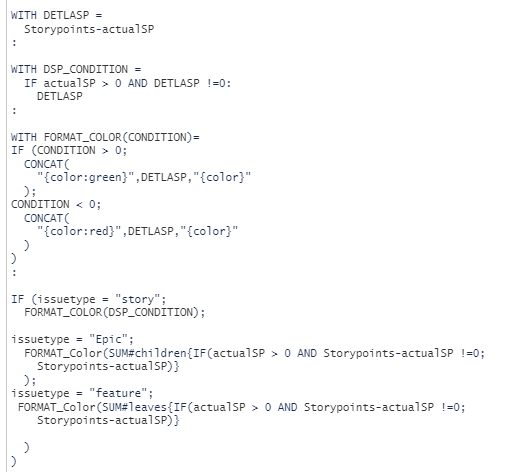

Nadya_BA July 11, 2022
@David Niro
I tried this formula, it returns correct value & coloring for stories but it returns always 0 for epics and features..
@David Niro Indeed, I'm trying to sum the differences of (expected story points - actual story points)  in Epic and feature level.
I'm not sure if we can sum differences between numbers .. but, yeah this is what I'm trying to do.

Hello @Nadya_BA ,
Could you please give the formula below a try?
WITH FORMAT_COLOR(color,value) =
"""{color:$color}$value{color}"""
WITH EPIC_CALC = IF(
issuetype = "Epic"; SUM#children{
IF(actualSP > 0 AND (storypoints - actualSP) !=0;
WITH DETLASP =
Storypoints-actualSP
WITH DSP_CONDITION =
IF(issuetype = "Story" AND actualSP > 0 AND DETLASP !=0;
DETLASP
WITH FEATURE_CALC = IF(
issuetype = "Feature"; SUM#leaves{
IF(DSP_CONDITION > 0;
FORMAT_COLOR("green",DSP_CONDITION);
DSP_CONDITION < 0;
FORMAT_COLOR("red",DSP_CONDITION);
EPIC_CALC > 0;
FORMAT_COLOR("green",EPIC_CALC);
EPIC_CALC < 0;
FORMAT_COLOR("red",EPIC_CALC);
FEATURE_CALC > 0;
FORMAT_COLOR("green",FEATURE_CALC);
FEATURE_CALC < 0;
FORMAT_COLOR("red",FEATURE_CALC)
Looking forward to your feedback.
Best,
David
Nadya_BA July 14, 2022
Thank you @David Niro . This worked!
