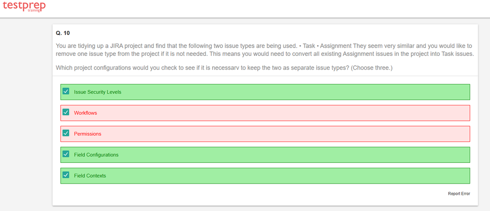

I am preparing for the ACP-100 exam, and this question is confusing me. Shouldn't the third correct answer be 'workflow' instead of 'field context'?
If you would think of it in terms of workflows - it’s clear that they can either be different or the same, most probably the same since issue types seems similar. (But migrating from 1 workflow to another is simple, statuses just need to be mapped)
However, when it comes to field context, if you have one field used across both issue types but with different options, that becomes a challenge. It would require some additional decisions and effort if we choose to proceed with this.
It is not possible to use a field in the same project with different options.
But probably 2 similar issue types can have different workflows. When they are almost similar. conditions, behaviors, postfunction, proberties can reject.
damn, then I would get it right, but for the wrong reasons ;)
