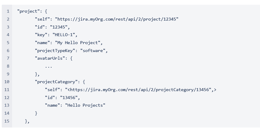

Manas Bajaj
November 2, 2021
Hello @Andy Heinzer
For 2 of our customers, who are running Jira server on-premise, versions 8.13.10 and 8.13.8, GET request sent to https://<jiraServer>/rest/api/2/issue/{issueKey} returns with fields.project.projectTypeKey, as shown below. The project object shown below is inside the fields object in the issue-by-key-response. You can see projectTypeKey = software in the response.
However, for another customer, who is running Jira server on-premise, version 7.6.4, the same request does not return the projectTypeKey.
For all three servers, the Jira REST API v2 is functional. So, how is it that the response from 7.6.4 is different than 8.13.x? Did the response change from Jira server 7.x to 8.x, even though the API version remained the same (v2)? Can you please confirm this?
Also, for what version of Jira did this switch happen?
Manas
