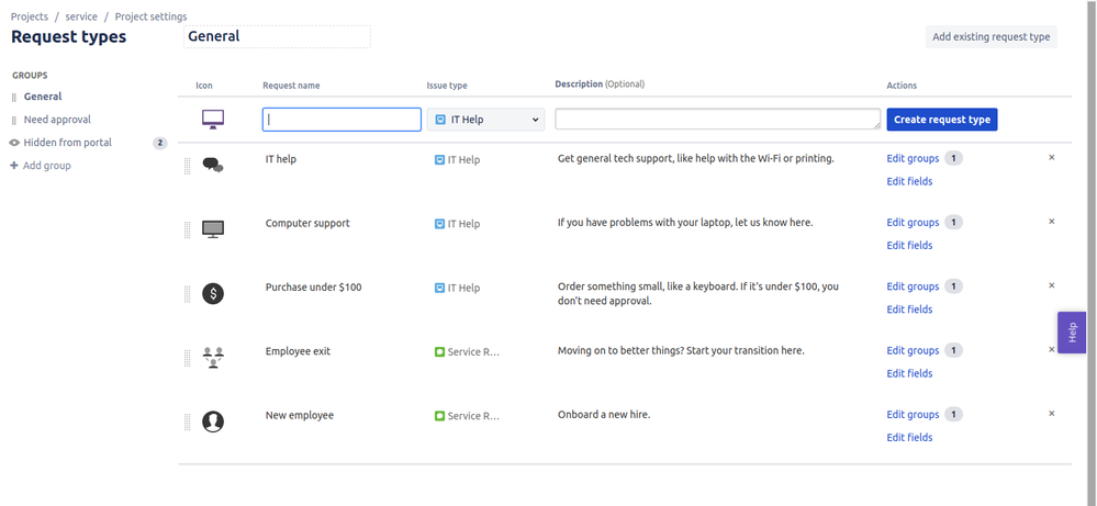

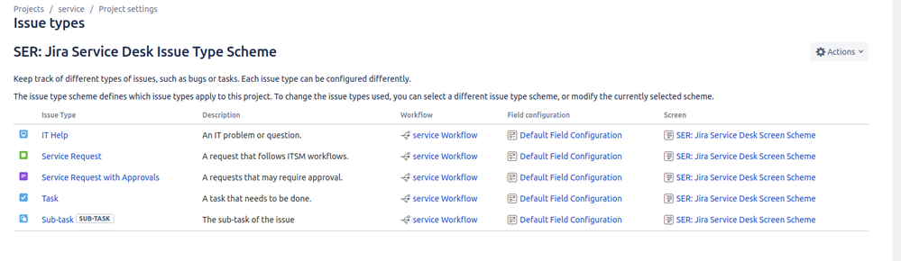

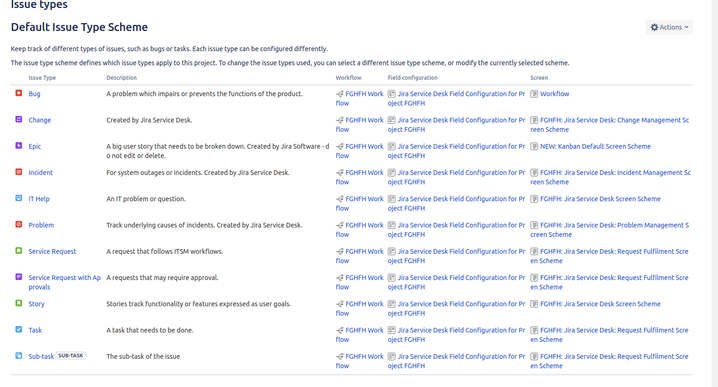

What are the steps I should follow to check that I have correct request types?
Maybe by doing, this should return that and this should that and if it doesn't that I have a problem with that and I should fix it.

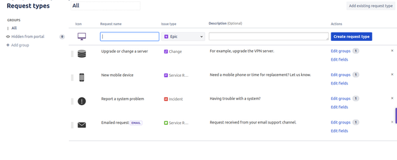

The request type for the only request I have
I only kept one request type for each issue type and deleted all the groups.
These are my issue types instead:

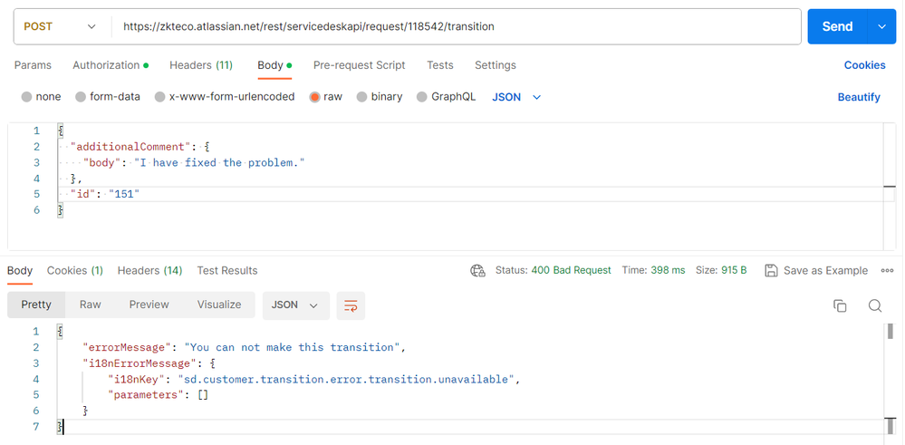

"I'm using the Service Desk APIs to change the status of an issue or ticket via the Transition REST API. The API token I'm using belongs to an administrator, and they are able to change the status in the web interface. However, when I use the following URL: https://org.atlassian.net/rest/servicedeskapi/request/{issueIdOrKey}/transition
, I encounter the following issue."
please help me on this

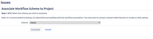

In the previous project, I used the Internal service desk template. Once again I could see all the transitions using the rest api but when I switched to classic workflow I couldn't see anything if used the service desk REST API.

Also, sorry for the confusion caused, you are already using a Classic project. I was mislead while reading that you switched to classic workflow, while 'classic' is actually the name of the workflow scheme you have associated to your Service Desk project (it is now clear from the above screenshot).

How do I know if a request type is set?

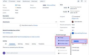

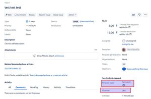

If you create the issue in Jira rather than from the customer portal, you may end up having a valid Jira issue but an invalid Service Desk request, since the request type is missing.
Missing request type:
Setting request type when missing:

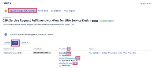

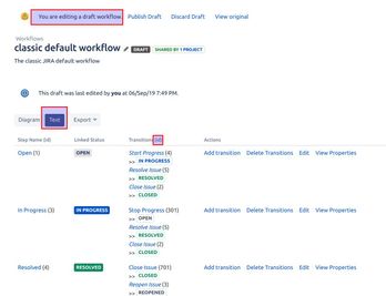

How do I get the transition ids?
Easiest way is to edit the workflow associated to the project. I did exactly the same you did, I created a JSD project using the internal template and I configured it to use the classic workflow scheme.
Then, go to project setting and edit the workflow (text mode), you will see the transition ids:
