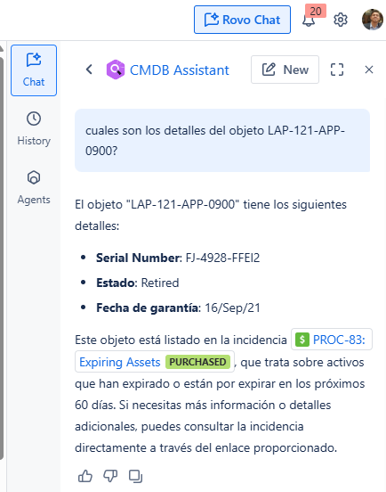

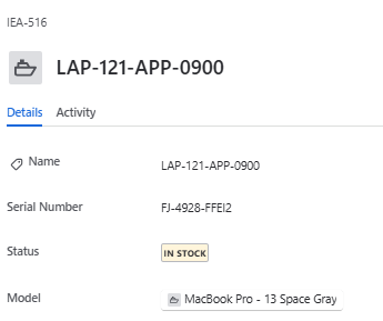

Lately, I’ve been testing various use cases with Rovo, and one of them was to create an agent that could act as an assistant for managing all the schemas I have configured in Assets. I’ve come to the conclusion that, as of now, with the basic agent creation available in Rovo Studio, it’s still not possible to fetch data or interact with CMDB objects.
In my case, I tried to define the agent’s instructions in quite a bit of detail, but even so, the responses it provides are always based on Jira work items or pages. For example, I specifically asked about the status of a particular object, and although its status in Assets is "In Stock", the agent consistently responds that it’s "Retired", clearly because there’s a work item where a change was requested in the description.
In any case, I’m sharing the instructions I used in case they’re helpful. But I believe that, at this point, the only real option is to go through Forge and build an agent that makes API calls.
