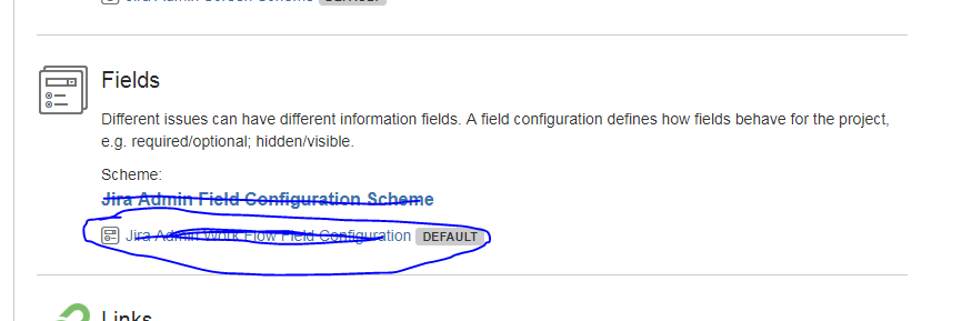

Your project would be using some Field configuration.
Go to Project's Administration, and see what that is.
 Search for Comment in the fields. And select Edit to add the script over there.
