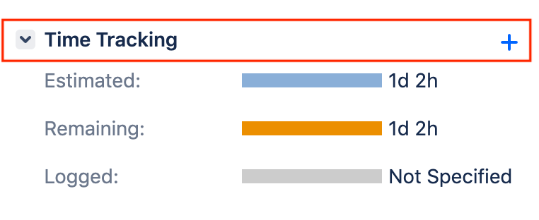

May this helps: Tempo Timesheet "Estimated" Time tracking.
And you can adjust the remaining time by the "Log work" option of the "+" symbol in the "Time Tracking" section.
I was able solve this by:
1. Ensuring both fields were available on the screen as stated above (adding time tracking to the issue type)
2. When entering original estimate, also enter the same number for remaining time.
If there is a number in remaining time, the calculation works, if you never set a number in remaining time, the calculation never runs.
This double entry is kind of annoying, If anyone knows of a way to have the calculation just assume original estimate is the starting number, PLEASE let me know :). In my opinion remaining time should be a calculated field that manual entry isn't allowed on.
