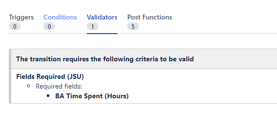

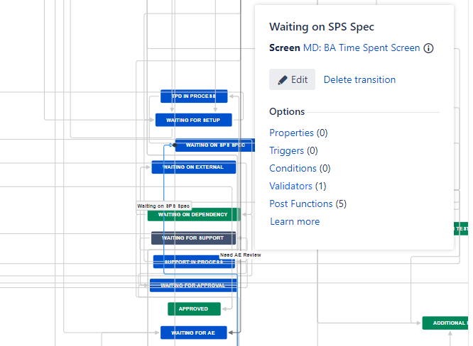

Thank you for the quick response @John Funk , These fields are required on multiple transitions. please find attached screenshot for your reference.
WOW - that's quite the workflow!
But is there a particular transition you need assistance with? If so, what exactly do you need it to do that it is not doing right now? And can you click on the Validators or Conditions and show a screenshot of those details?
@John Funk , these custom fields BA Time Spent (Hours),SE Time Spent (Hours), QE Time Spent (Hours) were added on multiple transitions. The requirement is ,these fields will not be mandatory when the issue types are Bug and Change Request and it must be required field for other issue types.
You are going to need an add-on like JMWE. With that tool you could do a custom validator that would probably get what you need.
Without the add-on, you are not going to be able to use the Validator because you can't put conditions on Validators with out of the box Jira.
