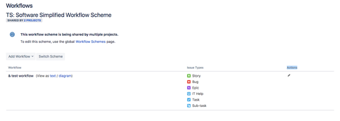

Basically, you can clear the value of custom fields by configuring the post function Update Issue Custom field in the workflow transition. Here are the steps:
1 - Navigate to your Project > Project Settings > Workflows > Click to Edit your workflow under the actions menu

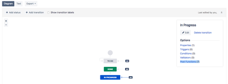

2 - Click in the intended transition > Post Functions
3 - Add the post function Update Issue Custom field, select the field you would like to clear and leave blank the Custom field value:
4 - Publish your workflow
