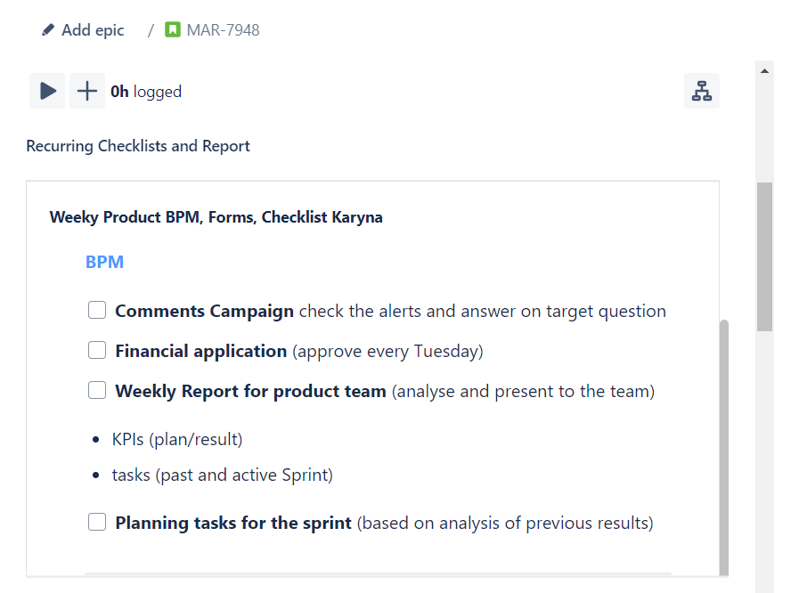

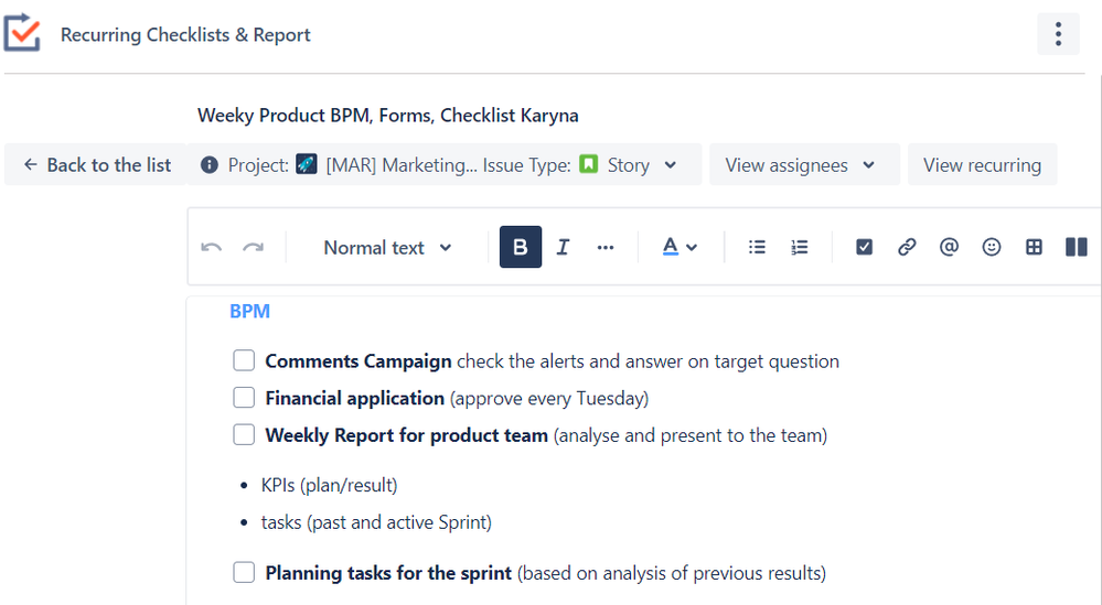

My team has developed Recurring Checklists and Report add-on for such a case. We also use this add-on for the marketing team. We have weekly and monthly checklists for every Marketing Manager. An example of a checklist is below
And the next pic is about how the checklist looks in the Jira issue (this task was created automatically)
Using this add-on you don`t need to create a lot of tasks connected to one topic, you can start a task with a checklist and repeat it by your custom schedule

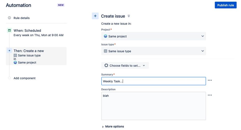

Hi Zoltan,
based on your input...
Note, there is much more you can do to customize this. For instance you could add a condition before the action such that you only create the new issue if the condition meet the criteria. For the action itself you can set the issue type, fill in certain fields, assign the issue etc.

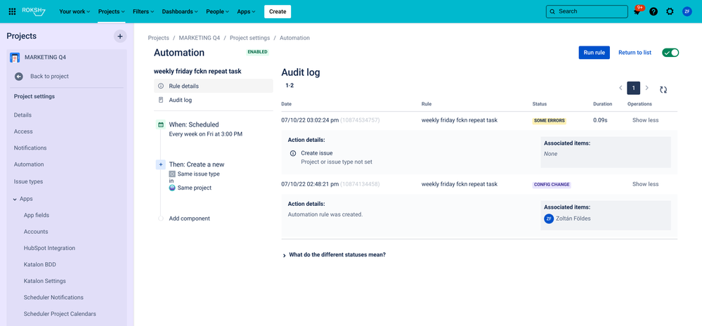

can you please provide a screenshot of your current rule as I am getting a little bit lost with your questions. As I tried to explain earlier I need to fully understand what your requirements are. Your response to that was that it was rather simple. But as we are seeing here it is not as simple as it first appears. It all comes down to exactly what you are trying to accomplish. Understanding the details will indeed make it simple again. In your screenshots please ensure you include the expanded details of each component, such as, the trigger, any conditions, and your actions.
Also be sure that you are creating a rule in a specific project if indeed it is a specific project that you are focused on here. You can ensure this is the case by simply going into project settings in the specific project in question.
Jack, Im doing all of that, still nothing and also all my questions still prevail above...

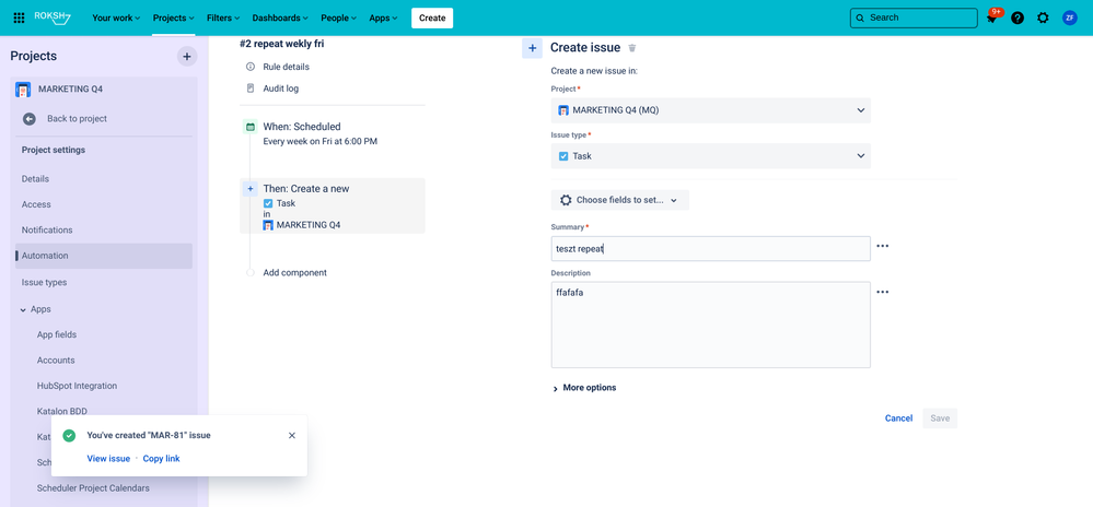

Just to clairify I chose a task in a specific project etc But still have no idea what 'Run Rule' is, should I click it after having created the rule or not?

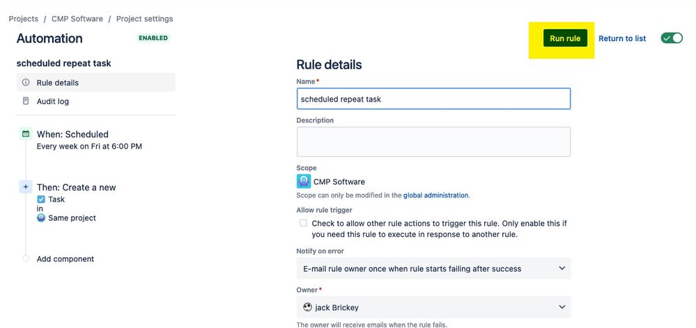

Regarding your "Run rule" question, are referring to the screen below? Assuming so, the "run rule" is used to test out a schedule rule so that you don't have to wait for the schedule to trigger.
Given the Image you provided above I would expect that if the run rule is successful in creating a task then you will also see hey new task created at 6 PM this evening.
