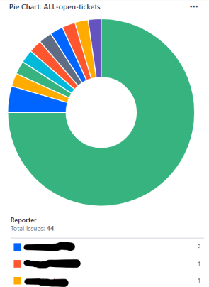

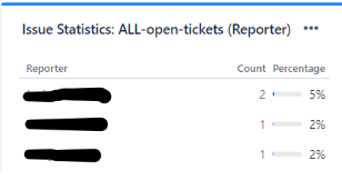

You can create a filter to get all the issues of interest and save this filter. If you need help with this filter creation, please send a message back. Now, on the dashboard, you add a gadget, which is either an 'Issue Statistics' or a Pie Chart (which is what you mentioned as your preference). In either of these gadgets, you will use Reporter as the Statistic Type and the saved filter as the Filter. Adding a couple of screen-captures for your reference.
