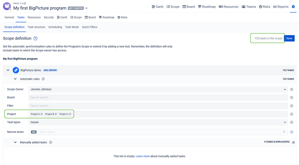

To observe tasks from Jira projects A, B, and C on a single Roadmap or Gantt chart in BigPicture you need to create a BigPicture program and then you need to add projects A, B, and C to the scope of the newly created BigPicture program.
In the below screen capture there are 725 Jira tasks in Projects A, B, and C combined.
Now, how to access the Tasks -> Scope definition configuration tab? On BigPicture's home screen (Overview), just click the 'Configuration (wrench)' icon next to your newly created BigPicture program.
