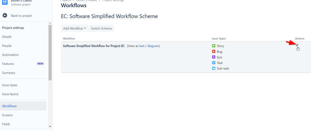

It depends on your project setup. Assuming you're using company-managed projects, and that your boards are not set to allow simplified workflow (which automatically sets the resolution when a ticket is dragged to the rightmost column), you'd need to edit the workflow transition to Closed, or whatever your final status is.
In your project, go to Project Settings, then to Workflows. Click the pencil icon to edit.

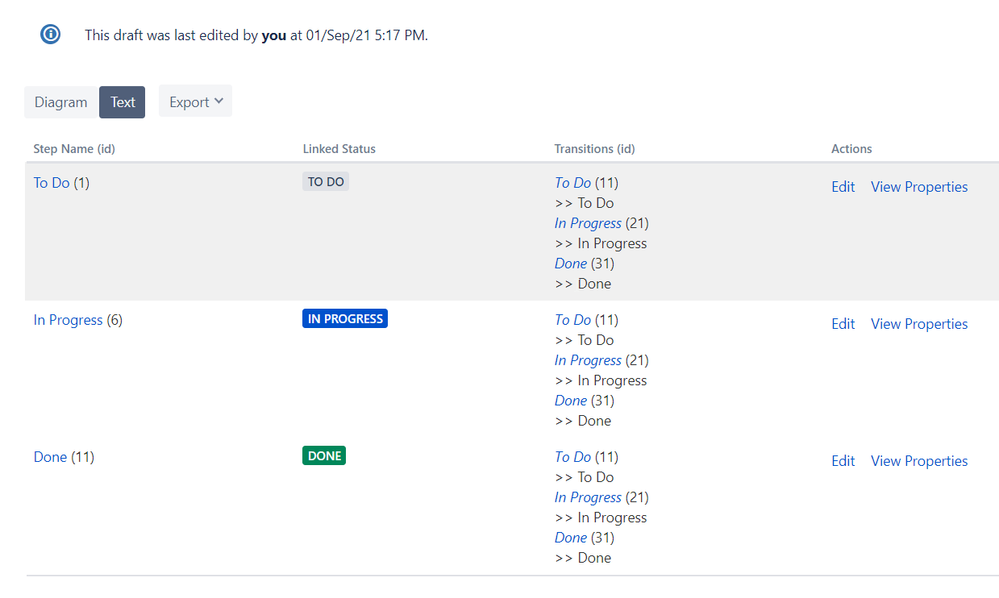

On the workflow edit page, choose the final status (in my example it's Done).

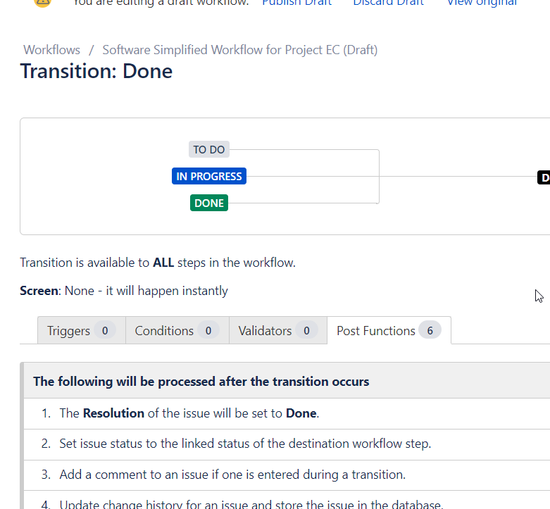

Then go to the Postfunctions tab and make sure there's an entry to set the resolution.
As Jack and Bill mentioned, you'll also want to update the postfunctions of transitions to other statuses to remove the resolution; if it's not already there click the Add Post Function option and use the Clear Field Value option. When you're done, publish the draft to make the new workflow take effect.
