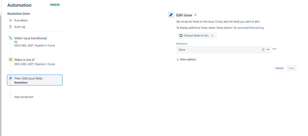

Nic Brough -Adaptavist-
June 24, 2022
You said "I have added resolution to all steps (create, edit, view) ", which reads as you entering a resolution when you create the issue.
June 23, 2022
You said you are resolving issues as they are created.  That's broken data.
June 23, 2022
That automation is not fixing the duff data you are putting in, it's just doing what a post-function would do at certain times.
It doesn't repair the broken data you are putting in.
June 23, 2022
Argh, NO, that's exactly the wrong thing to do.
You are now resolving all your issues as they are created or edited, so you've made a complete nonsense of all Jira's reporting on open and closed issues.
You should only put the resolution field on screens used in transitions that move an issue into a closed status.  You should have a post function to clear it on "re open" transitions.

Jan Šimek
June 23, 2022 edited
Snímek obrazovky 2022-06-23 123037.png Actualy I am not, because I have only put the resolution field in the screens and set this automation.
Jan Šimek
June 23, 2022
I have added resolution to all steps (create, edit, view) and set automation, which is changing it for any request when it comes to certain fields. Which solved my issue.
