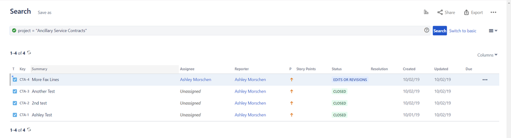

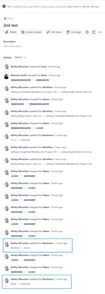

What I did find is that the history of the issues shows I've set the resolution (when it transitions) but as soon as I re-run the search, the resolution is still showing empty. (See Pic E)

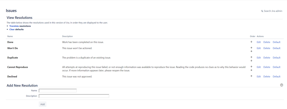

Pic B

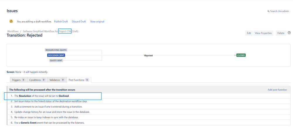

Pic C
Pic D
Pic E

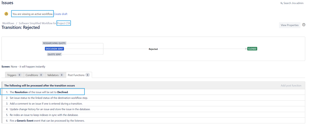

lots of great screenshots! thanks for sharing. My first suggestion is to ensure that you have published the workflow.
Thanks! I wish it was that easy, but I tried that. It was just quicker for me to navigate to the transition through edit. Here's showing it as published:
EDIT: Just to be 100% certain, I tried it again. Here's the history log and the search I ran after that, showing the resolution still doesn't show as set -- even though the history log says I updated it.

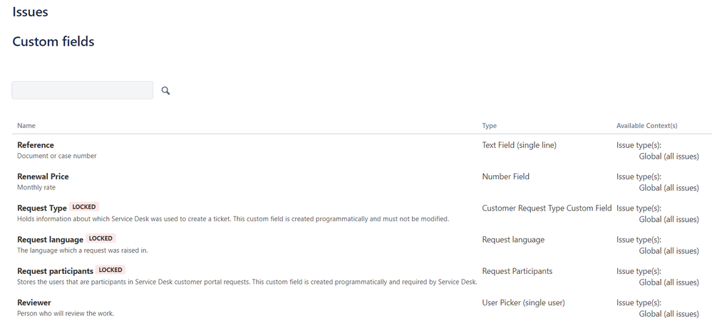

another thought - do you have a custom field called Resolution and mistakenly either setting that or setting the real one but viewing the other in filter result? Long shot but I have sure seen it happen.

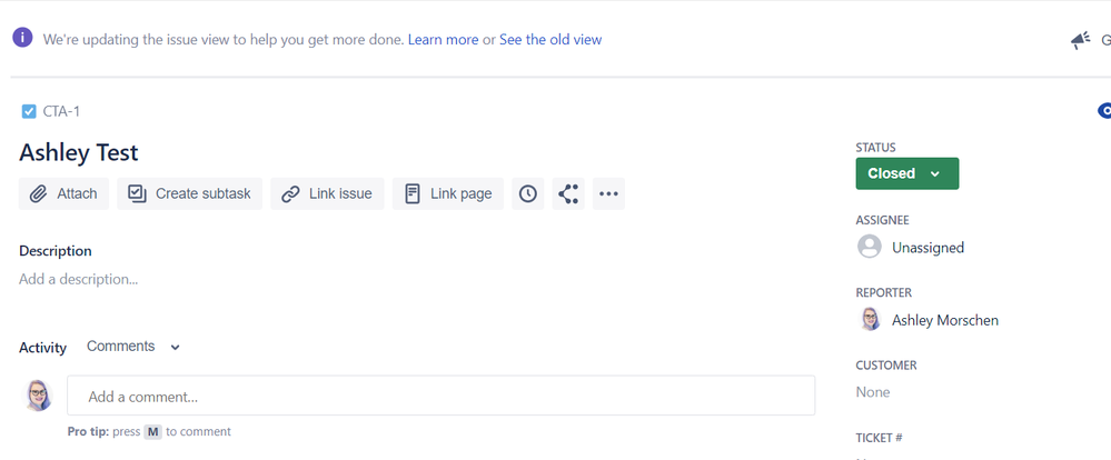

could you check the detailed issue view just to confirm that it isn't being set. something like this.... (new issue view)
Unfortunately for me, it's neither of those.
Custom Fields (letter Rs)
Detailed Issue View
