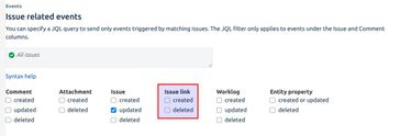

Hello.
As you can see, when I create issuelink thru REST API , it doesn't create on BigPicture:
but it creates in issue links:
Only, when I change description to another value - raise event "issue updated", and after that link creates on big picture:

@[deleted]
Thank you for your patience regarding this.
Please be informed that our developers managed to create a link in Jira using the POST HTTP method. The link appeared in the Gantt chart instantly after refreshing the page. This is the code that was used:
POST https://INSTANCE-NAME.atlassian.net/rest/api/2/issueLinkContent-Type: application/json Authorization: Basic bWFyY2luLmtpdGFAc29mdHdhcmVwbGFudC5j******** { "outwardIssue": { "key": "SCRUM-1" }, "inwardIssue": { "key": "SCRUM-2" }, "type": { "name": "Gantt End to Start" } }
Also, our developer found that your code does not meet some of the requirements listed in the documentation. The key differences are:
Please verify if such a command will work for you.
