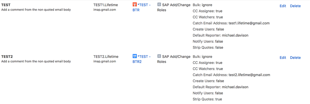

Did you choose in which project you want this mail handler to create issues or add comments? Take a look at an example setup I have below. Both email handlers create new issues, or add new comment to specific project:
Thanks @Alex Koxaras -Relational- .
Here's the thing: I set up 2 test email handlers, using 2 different email addresses as shown below. I have selected the default project as well, as shown in your image. I have 2 separate default projects, test1 and test2 (mine appear below).
However, as far as I understand, the default project is only for Creating issues. It does not limit commenting to a single project (my example below).
To test this, I sent an email to the test1 email address with the TEST2 issue key in the subject. The test1 mail handler put a comment on the test2 project - and this is what I am trying to limit. It appears I can comment on ANY project in my instance when this is turned on. For example, if I put a Jira issue project key in the email subject header that is a LIVE, PRODUCTION project, and not one of the test projects I created, and send it to one of the handler addresses below, the test server/handler will comment on the live project (something I definitely don't want).

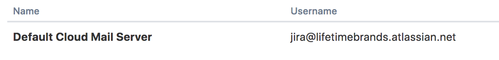

@David Roberts One thing that might help is to setup a dedicated, separate email and NOT use the Atlassian Default Cloud Mail Server:
in the incoming email server/handler. I suspect that when I was having issues, both my internal project and our 3rd party service providers were both using the default server, therefore if our projects happened to be mentioned or included in the subject line, we would get strange comments from our 3rd party service provider. Once we set up a dedicated email and replaced that in the settings, the cross-pollination stopped. Are you using the Default Cloud Mail Server?
So @Michael Davison it's good to know that what I proposed back on September was the solution to your problem. How come you didn't try it back then?
Alex you suggested using a different handler.
The solution is to use a dedicated email as the server, and not use the default cloud server email that Jira provides.
