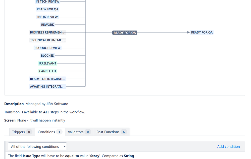

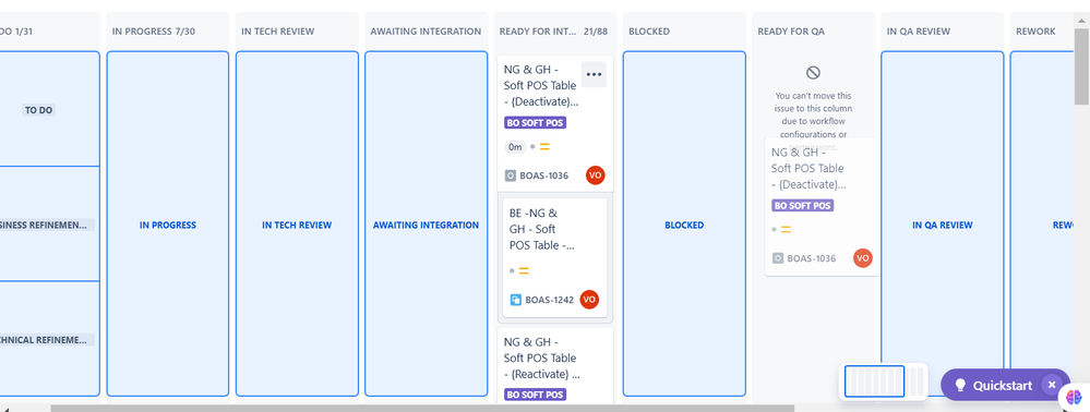

Please, I would like to restrict the transition to my QA column so that only stories can be transitioned to that column. Even though the stories have subtasks, I don't want the subtasks to move to the QA column, only the stories.

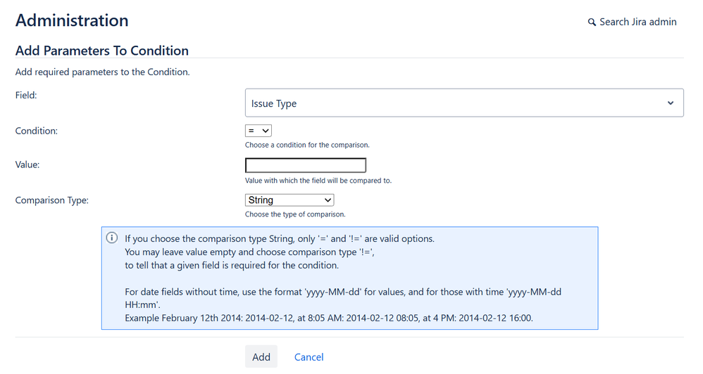

I tried using the value field condition, but I got no option to select the actual issue type.

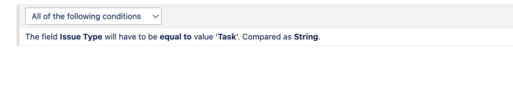

You are on the right path. Type the issue type name in the value field. Below is an example
For your requirements, it will be story instead of the Task in this example :)

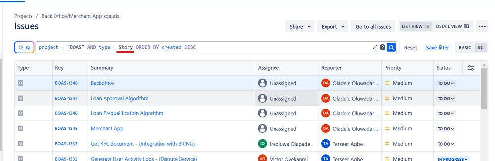

What is the issue type name in your site? May it is has an extra space or capitalisation difference?
hi @Fazila Ashraf i updated the condition to not equals and then changed back to equals and it works now. Thanks a lot
